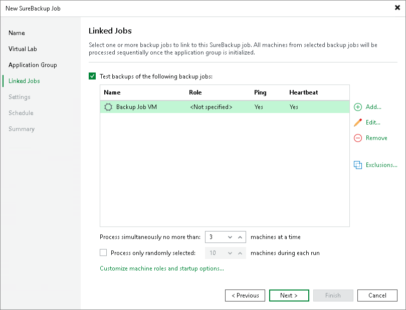

Creating SureBackup Job
  1. At the Linked Jobs step of the wizard, add a backup job to use as a source of backups for the SureBackup job and specify settings for backup job processing. To learn more, see Link Backup or Replication Job and Specify Recovery Verification Options and Tests.
TIP
[For full recoverability testing mode] You can skip this step if you selected an application group at the Application Group step of the wizard.
