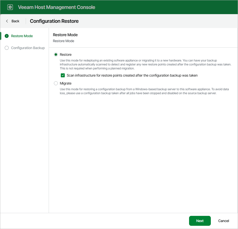

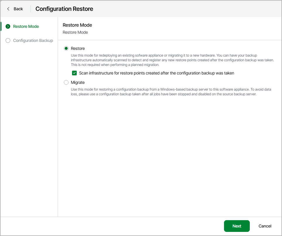

Step 2. Select Restore Mode
At the Restore Mode step of the wizard, do the following:
  1. In the mode selection, select Restore.
  2. Select the Scan infrastructure for restore points created after the configuration backup was taken check box.
In the Restore mode, Veeam Backup & Replication retrieves configuration data from the backup and stores it in the target database. After that, Veeam Backup & Replication performs an additional rescan of VM replicas and backup repositories connected to the backup server, and runs the tape library cataloging process. Rescan helps synchronize potential changes between the backup infrastructure and restored database that took place from the moment when the configuration backup was created till the present time. As a result, the target configuration database will contain information about restore points that were created after the configuration backup was taken, and this information is displayed in the Veeam Backup & Replication console.

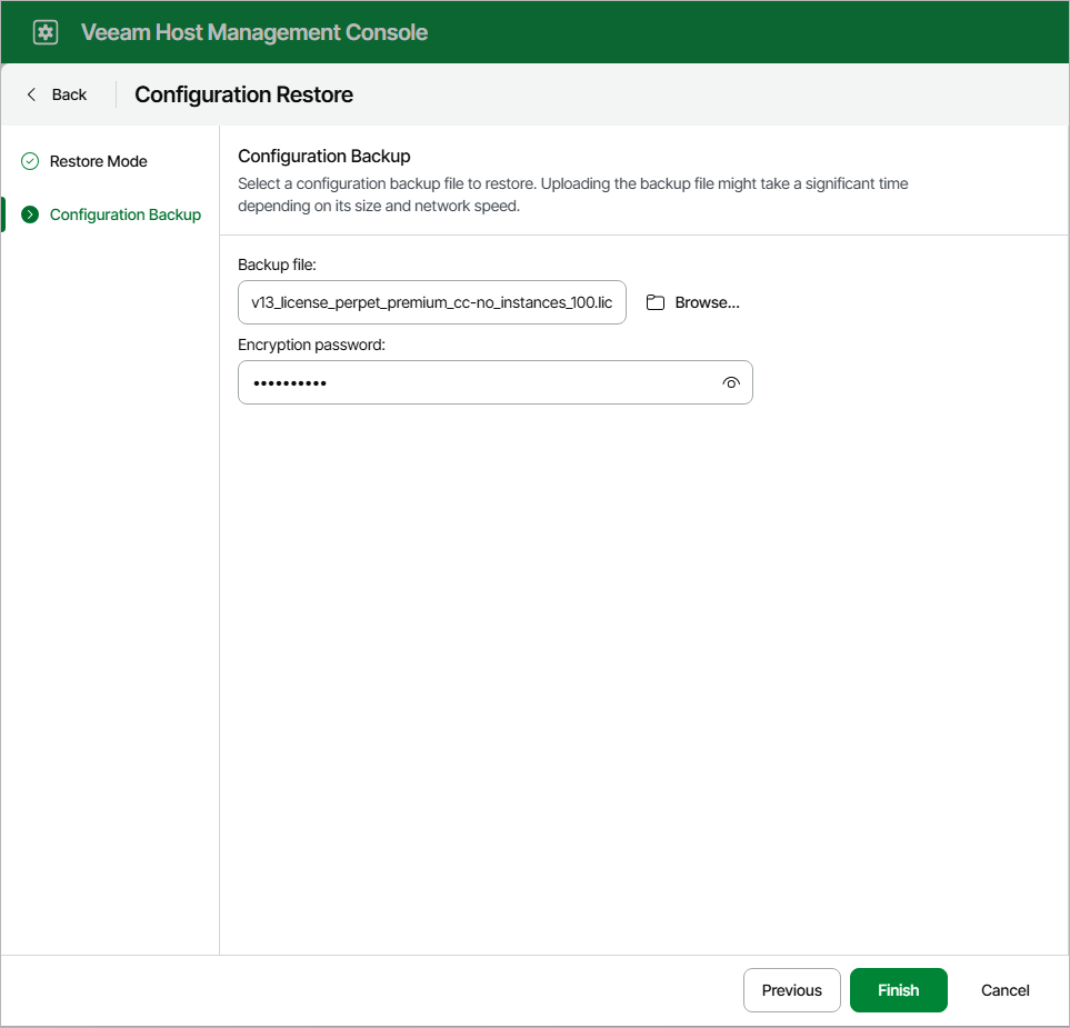

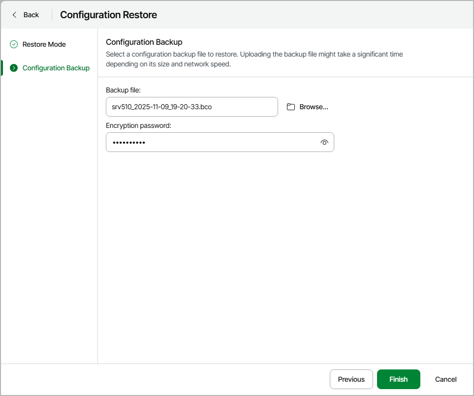

Step 3. Select Configuration Backup
At the Configuration Backup step of the wizard, do the following:
  1. Click Browse to select a configuration backup file.
  2. Specify the backup encryption password.
  3. Click Finish.
Restoring Configuration Database using Veeam Host Management
Veeam Backup & Replication will use the specified backup file to perform the restore of configuration database.
