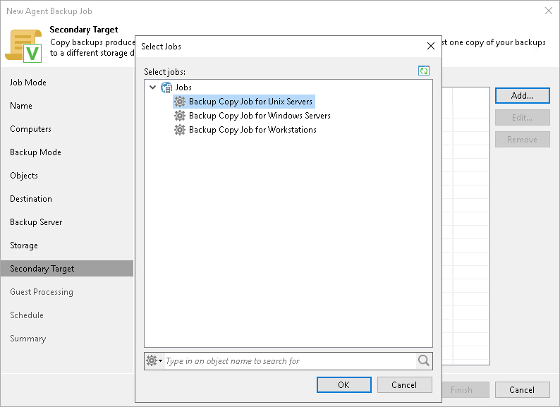

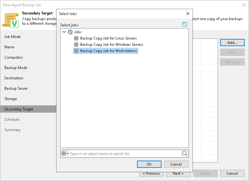

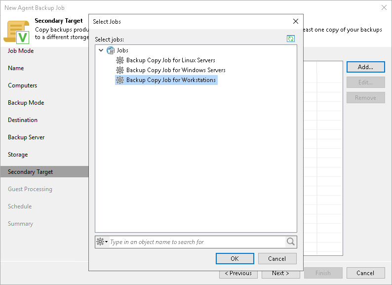

  1. Click Add.
  2. From the jobs list, select a backup to tape or backup copy job that must be linked to the Veeam Agent backup job. You can link several jobs to the backup job, for example, one backup to tape job and one backup copy job. To quickly find the job, use the search field at the bottom of the wizard.
