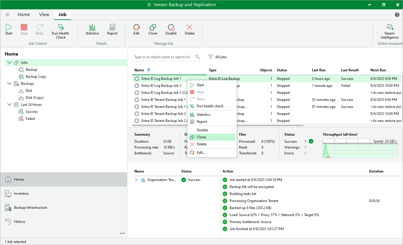

To clone a log backup job:
  1. Open the Home view.
  2. In the inventory pane, select Jobs .
  3. In the working area, select the job and click Clone on the ribbon. Alternatively, right-click the job and select Clone .
After a job is cloned, you can edit all its settings, including the job name.
