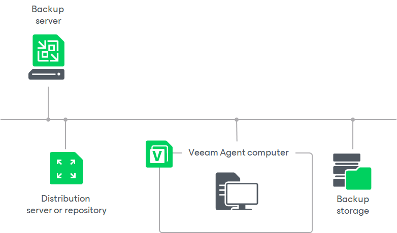

Veeam Agent Management Infrastructure
The Veeam Agent management infrastructure comprises the following components:
Veeam Backup Server
The Veeam backup server is the core component in the backup infrastructure that fills the role of the “configuration and control center”. To use the Veeam Agent management functionality offered by Veeam Backup & Replication, you can use the backup server that is already running in your backup infrastructure or deploy a separate backup server.
To learn more, see Deployment.

Distribution Server
The distribution server is an architecture component in the Veeam Agent management infrastructure used for automated deployment of Veeam Agent setup files to protected computers. The distribution server comprises the Veeam Distribution Service. When you instruct Veeam Backup & Replication to install Veeam Agent on a protected computer, the Veeam backup server communicates uses the distribution server to upload Veeam Agent setup files to the target computer.
By default, the role of the distribution server is assigned to the backup server itself. However, you can deploy a dedicated distribution server to reduce load on the backup server. To deploy a distribution server, you need to add a Windows-based or Linux-based server to Veeam Backup & Replication. To learn more, see Adding Microsoft Windows Servers and Adding Linux Servers. After you assigned the role of distribution server, you need to select this server in the properties of a protection group. To learn more, see Creating Protection Groups.
