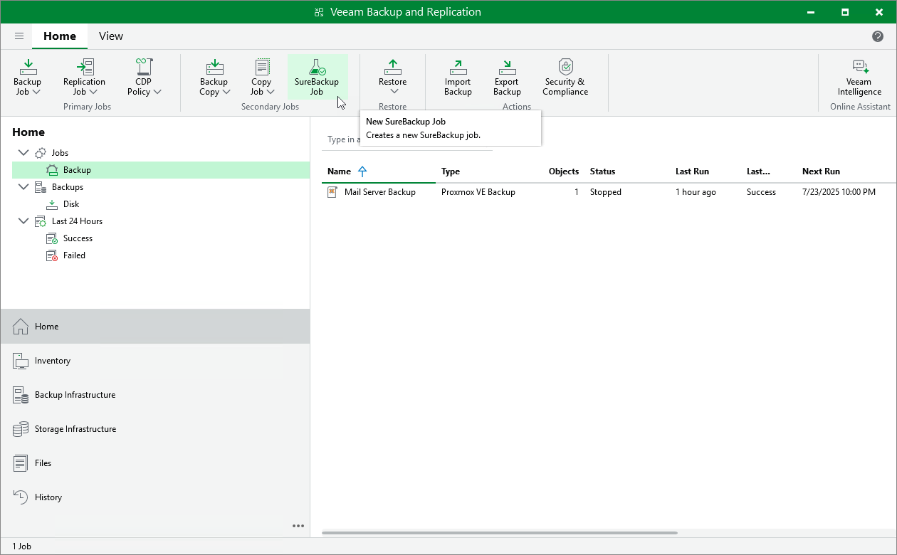

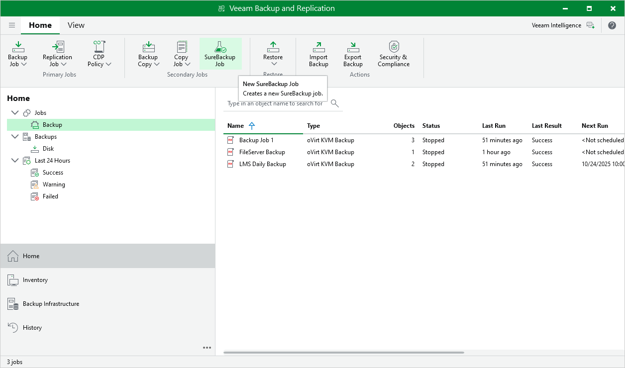

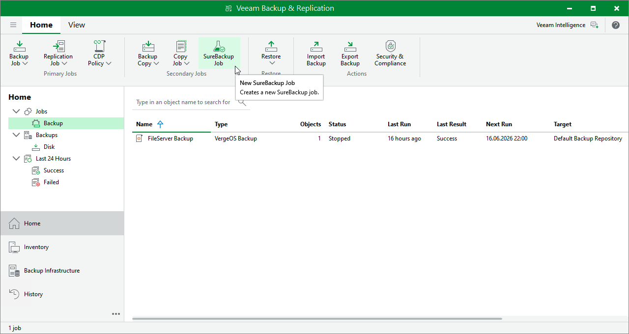

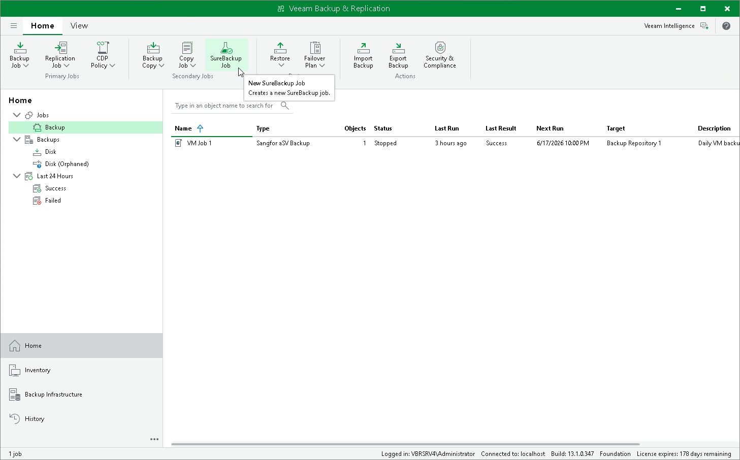

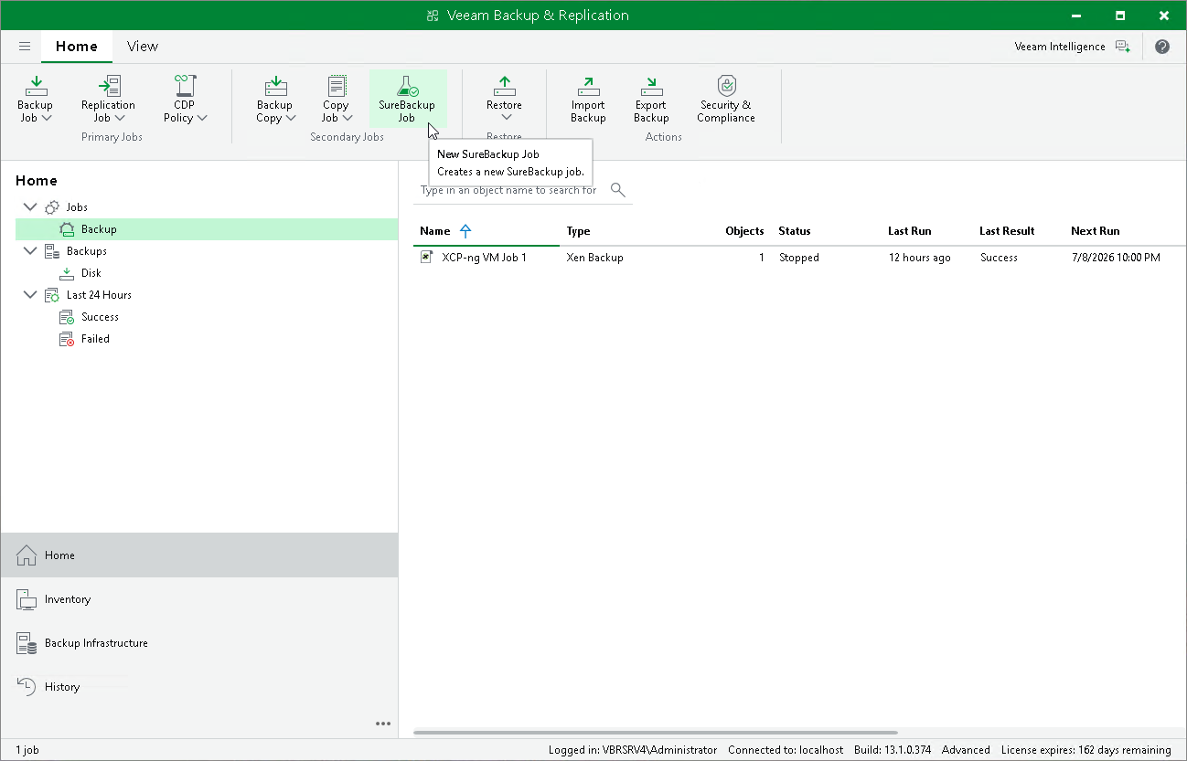

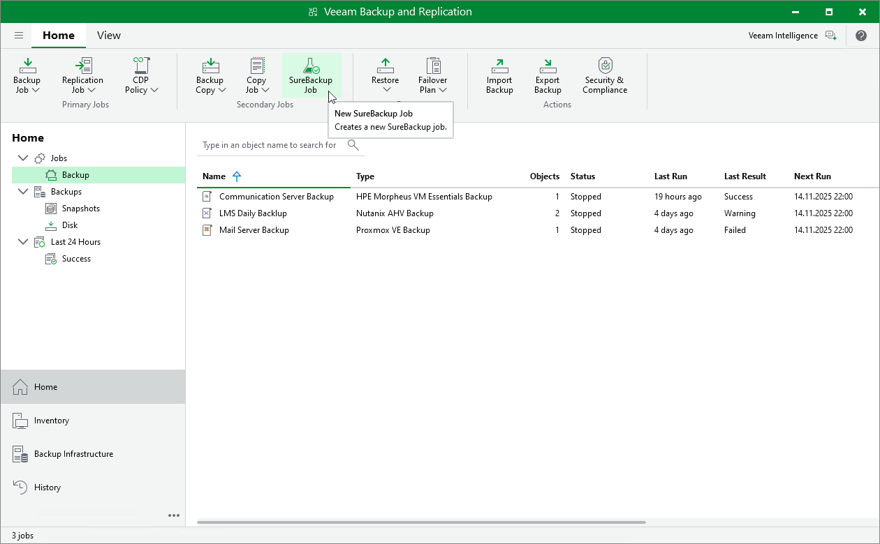

  1. Open the Home view.
  2. In the inventory pane, select Jobs > Backup and click SureBackup Job on the ribbon.
  3. At the Name step of the New SureBackup Job wizard, select the Backup verification and content scan only verification mode, and then complete the wizard as described in section Creating SureBackup Jobs.
