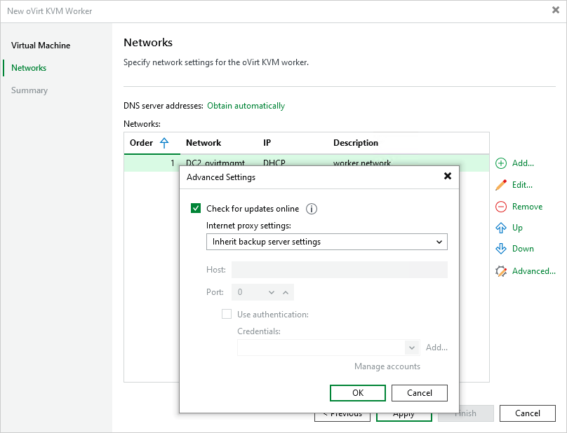

Configuring Internet Proxy for Updates
To check for available package updates for the worker, Veeam Backup & Replication automatically connects to Veeam repositories over the internet. If the worker is not connected to the internet, Veeam Backup & Replication uses backup server update settings to obtain the configuration of an internet proxy that provides access to the necessary repositories. However, you can enter specific internet proxy settings that will be used for the current worker. To do that, click Advanced and do the following in the Advanced Settings window:
  1. From the Internet proxy settings drop-down list, select Use custom settings.
  2. In the Host field, enter a DNS name or an IPv4 address of the internet proxy.
  3. In the Port field, enter the port used on the internet proxy for HTTP or HTTPS connections.
  4. If your internet proxy requires authentication, select the Use authentication check box, and select credentials of the account configured on the proxy to access the internet.
For credentials to be displayed in the Credentials list, they must be added to the Credentials Manager as described in section Standard Accounts. If you have not added the necessary credentials to the Credentials Manager beforehand, you can do this without closing the wizard.
If the worker does not have access to the internet and no internet proxy is configured for the worker, you can instruct Veeam Backup & Replication not to update it. To do that, clear the Check for updates online check box.
