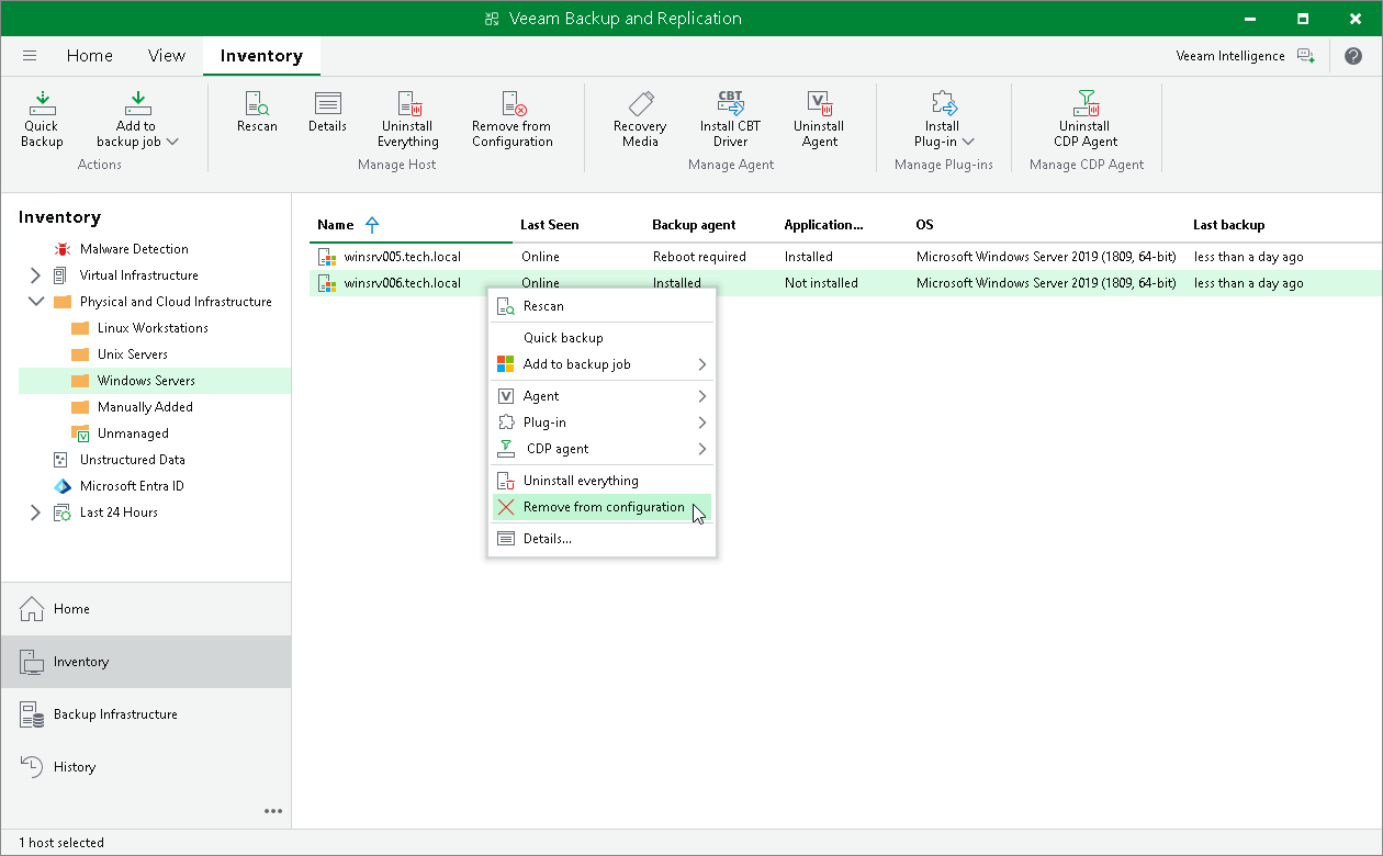

To remove a computer from a protection group:
  1. Open the Inventory view.
  2. In the inventory pane, expand the Physical and Cloud Infrastructure node and select the necessary protection group.
  3. In the working area, select the necessary computer and click Remove from Configuration on the ribbon or right-click the computer and select Remove from configuration.
Backups created for computers that were removed from a protection group remain intact in the backup location. You can delete this backup data manually later if needed.
NOTE
You cannot remove a computer from the protection group if this computer is a failover cluster node.
