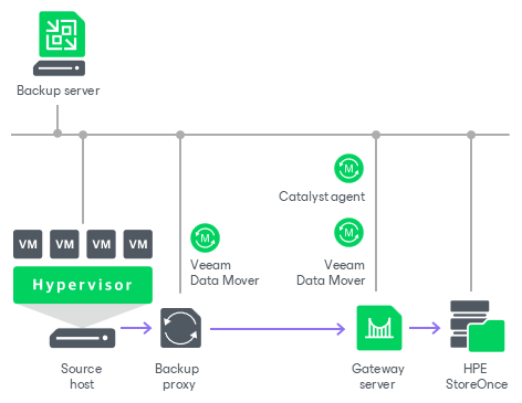

To communicate with HPE StoreOnce, Veeam Backup & Replication uses two Veeam Data Movers that are responsible for data processing and transfer:
  • Veeam Data Mover on the VMware or off-host backup proxy
  • Veeam Data Mover on the gateway server
The HPE StoreOnce storage cannot host Veeam Data Mover. For this reason, to communicate with the HPE StoreOnce storage, you need to deploy a gateway server. Veeam Backup & Replication will automatically deploy Veeam Data Mover on this gateway server. For more information, see Gateway Servers.
When any job addresses the backup repository, Veeam Data Mover on the gateway server establishes a connection with Veeam Data Mover on the VMware or off-host backup proxy, enabling efficient data transfer over LAN or WAN.
HPE StoreOnce
The gateway server is selected when you assign a backup repository role to the HPE StoreOnce appliance. You can define the gateway server explicitly or instruct Veeam Backup & Replication to select it automatically.
