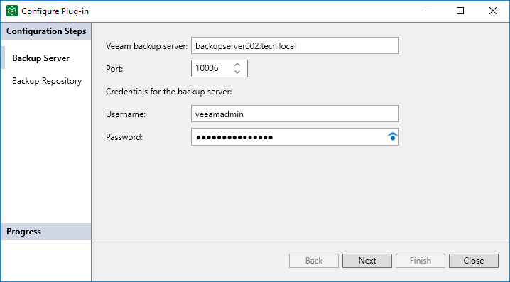

  1. On the Veeam Plug-In server, launch the Configure Plug-In wizard and set the scale-out repository as the target for backups:
Veeam Backup Repositories
Alternatively, you can use the following command in the command line interface:
MSSQLConfigTool --set-repository

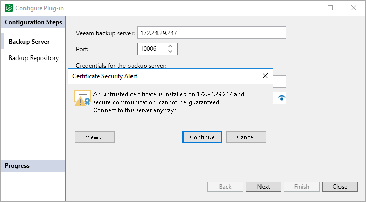

  1. If you connect to the specified Veeam Backup & Replication server for the first time, Veeam Plug-In displays the Certificate Security Alert window. After you review the certificate, click Continue to confirm the connection.

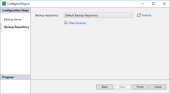

  1. At the Backup Repository step of the wizard:
  1. From the Backup repository drop-down list, select the scale-out repository.
  2. Click Map backups to map the imported backups stored in the backup repository.
You can map backups only in the graphic user interface.
