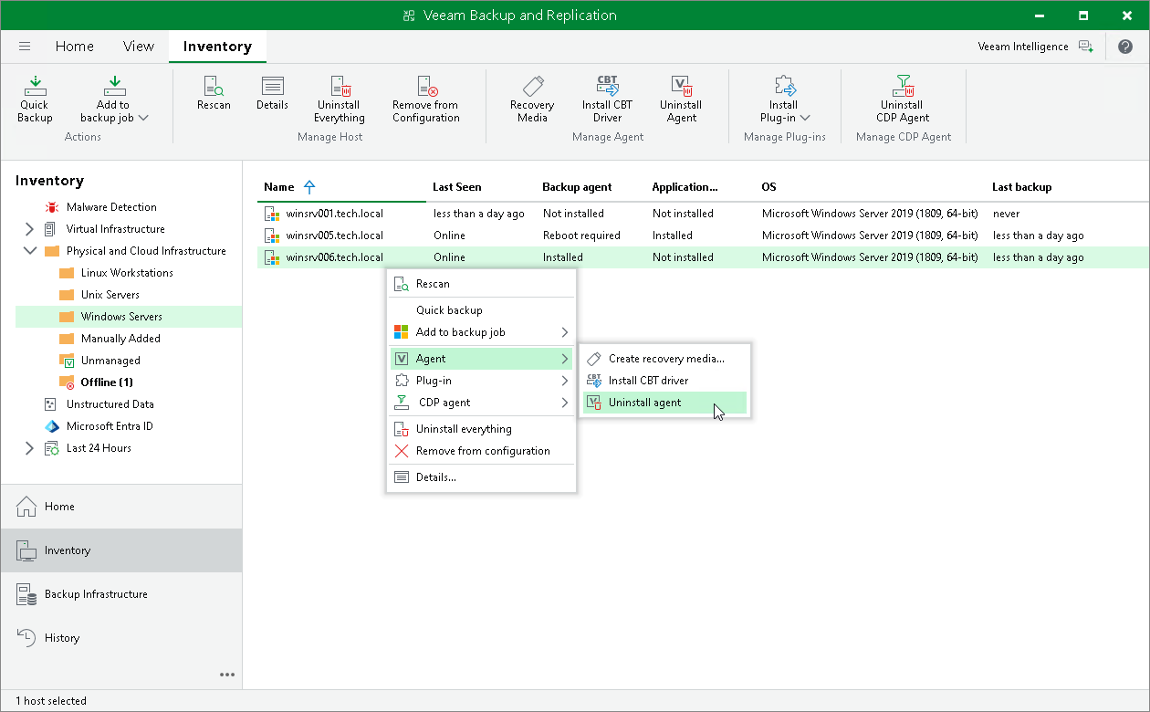

To uninstall Veeam Agent:
  1. Open the Inventory view.
  2. In the inventory pane, expand the Physical and Cloud Infrastructure node and select the necessary protection group.
  3. In the working area, select the necessary computer and click Uninstall Agent on the ribbon or right-click the computer and select Agent > Uninstall agent.
  4. In the displayed notification window, click Yes.
