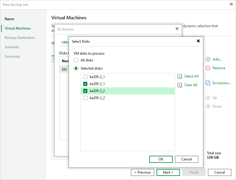

By default, jobs process all disks attached to VMs included into the backup scope. However, you can instruct Veeam Plug-in for oVirt KVM to back up only specific virtual disks related to the selected backup scope. To do that,
  1. Click Exclusions.
  2. In the Exclusions window, switch to the Disks tab and click Add.
  3. In the Add Objects window, select a resource that you have added to the backup scope and click OK.
  4. Back to the Exclusions window, select the resource and click Edit.
  5. In the Select Disks window, select the Selected Disks option and click Add.
  6. Select disks that you want to back up.
Disks that you do not select will be excluded from the backup job.
