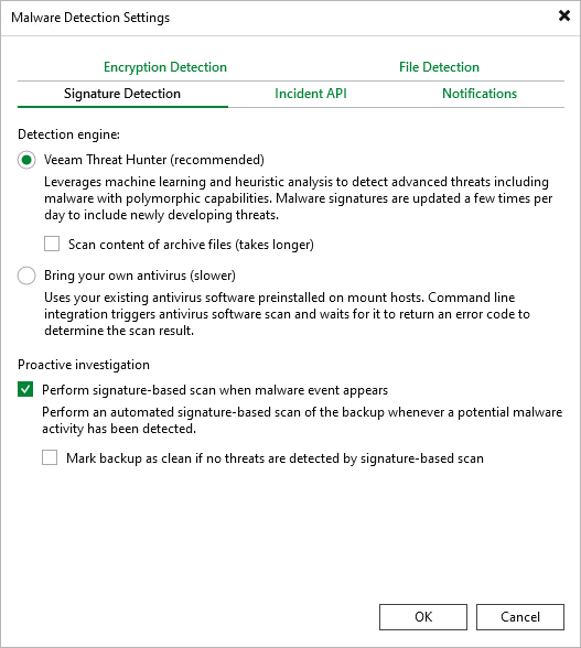

You can configure default engines to scan restore points. To do this, perform the following steps:
  1. From the main menu, select Malware Detection > Signature Detection.
  2. Specify a detection engine:
  1. To additionally scan restore points marked as Suspicious after guest indexing data scan or inline scan, select the Perform signature-based scan when malware event appears check box. In this case, a Scan Backup session will run automatically:
    • If malware activity is detected,  the Veeam Analyzer Service will create a new malware detection event and mark the restore point and the machine as Infected.
    • If malware activity is not detected, the Veeam Analyzer Service will create a new malware detection event with the Informative status. After that, you can mark a restore point and a machine as Clean. For more information, see Managing Malware Status.
    • If a restore point contains encrypted disks, such disks cannot be mounted and will not be scanned. In this case, a scan session will display mount errors in the log file and will be finished with Warning. The Veeam Analyzer Service will not create any malware detection events.
For more information on how to exclude machines with encrypted disks from the signature-based scan scope, see this KB article.
To automatically mark a restore point and a machine as Clean, select the Mark backups as clean if no threats are detected by signature-based scan check box. In this case, a malware detection event with the Informative status will not be created and a Clean event will be created instead.
