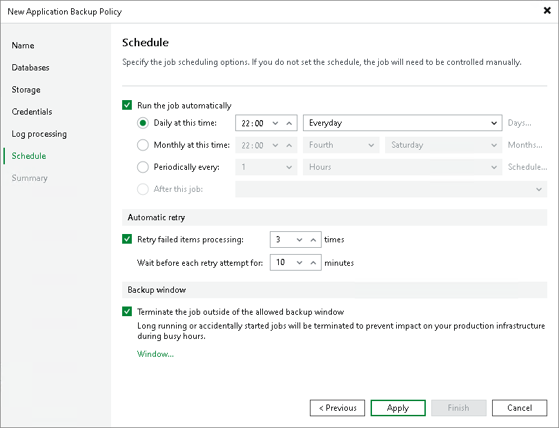

At the Schedule step of the wizard, specify the schedule according to which you want to perform backup.
To specify the job schedule:
  1. Select the Run the job automatically check box. If this check box is not selected, you will have to start the backup job manually to create backup.
  2. Define scheduling settings for the job:
  • To run the job at specific time daily, on defined week days or with specific periodicity, select Daily at this time. Use the fields on the right to configure the necessary schedule.
  • To run the job once a month on specific days, select Monthly at this time. Use the fields on the right to configure the necessary schedule.
  • To run the job repeatedly throughout a day with a specific time interval, select Periodically every. In the field on the right, select the necessary time unit: Hours or Minutes.
  • To define the permitted time window for the job, click Schedule and use the time table. In the Time Periods window, specify the exact time when the job must start.

  1. In the Automatic retry section, define whether Veeam Backup & Replication or Veeam Plug-In (depending on the selected job mode) must attempt to run the backup job again if the job fails. Enter the number of attempts to run the job and define time intervals between them. If you select continuous backup, Veeam Backup & Replication or Veeam Plug-In will retry the job for the defined number of times without any time intervals between the job runs.
  2. In the Backup window section, define the time interval within which the backup job must complete. The backup window prevents the job from overlapping with production hours and ensures that the job does not impact performance of your server. To set up a backup window for the job:
  1. Select the Terminate job if it exceeds allowed backup window check box and click Window.
  2. In the Time Periods window, define the allowed hours and prohibited hours for backup. If the job exceeds the allowed window, it will be automatically terminated.
