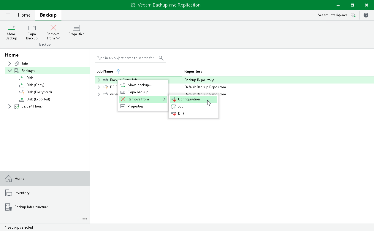

To remove a backup from the configuration:
  1. Open the Home view.
  2. In the inventory pane, select the Backups node.
  3. In the working area, select the backup you want to remove, press and hold the [Ctrl] key, right-click the backup and select Remove from > Configuration.
