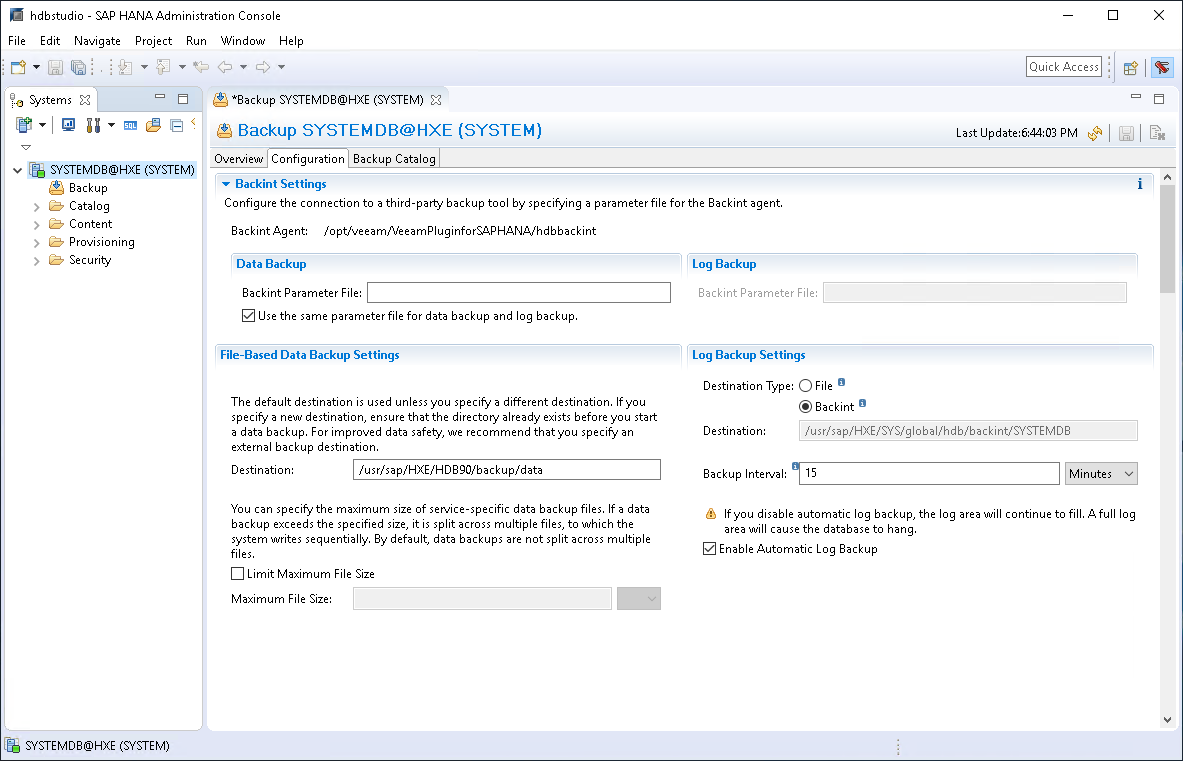

Verifying Configuration of Veeam Plug-In for SAP HANA
When you finish the plug-in configuration wizard, the plug-in creates a soft link in the /hana/shared/<SID>/global/hdb/opt directory.
To verify that the Backint Agent is configured correctly, do the following:
  1. Connect to the database using SAP HANA Studio.
  2. Go to Backup/Configuration.
  3. In the Backint Agent field, make sure that the specified path leads to /opt/veeam/VeeamPluginforSAPHANA/hdbbackint.
