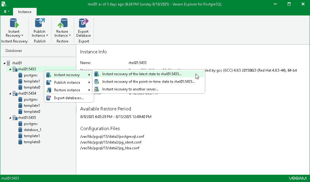

Step 1. Launch Instant Recovery Wizard
To launch the Instant Recovery wizard, do the following:
  1. In the navigation pane, select an instance.
  2. On the Instance tab, select Instant Recovery > Instant recovery of the latest state to <original_location>.
Alternatively, you can right-click an instance and select Instant recovery > Instant recovery of the latest state to <original_location>.
The name of the instant recovery option depends on the restore point you select during the application item restore process in the Veeam Backup & Replication console.
  • If you select the most recent available restore point, the option name is displayed as Instant recovery of the latest state to <original_location>.
  • If you select any other restore point, the option name is displayed as Instant recovery of the state of <point_in_time> to <original_location>.
Launching Instant Recovery Wizard
