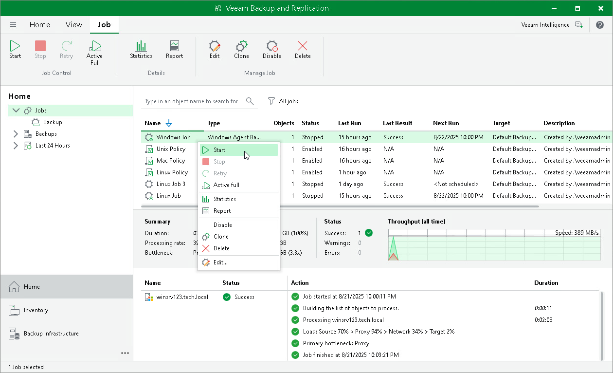

Starting Jobs
To start a job:
  1. Open the Home view.
  3. In the working area, select the Veeam Agent backup job and click Start on the ribbon or right-click the job and select Start.

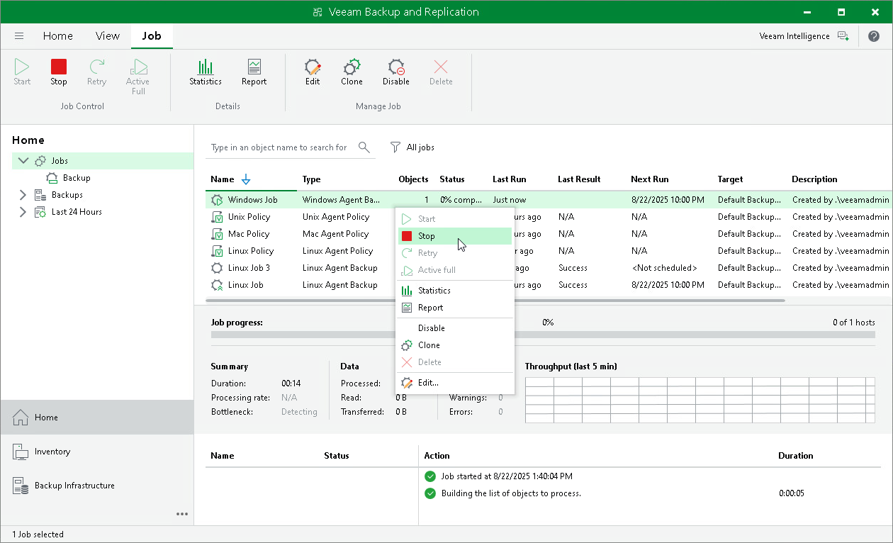

Stopping Jobs
You can stop a Veeam Agent backup job in one of the following ways:
  • Stop job immediately. In this case, Veeam Backup & Replication will produce a new restore point only for those computers in the job that have already been processed by the time you stop the job.
  • Stop job gracefully. In this case, Veeam Backup & Replication will produce a new restore point only for those computers in the job that have already been processed and for computers that are being processed at the moment.
To stop a job immediately:
  3. In the working area, select the Veeam Agent backup job and click Stop on the ribbon or right-click the job and select Stop. In the displayed window, click Immediately.
To stop a job gracefully:
  2. In the inventory pane, click Jobs.
  3. In the working area, right-click the job and select Stop. In the displayed window, click Gracefully.
