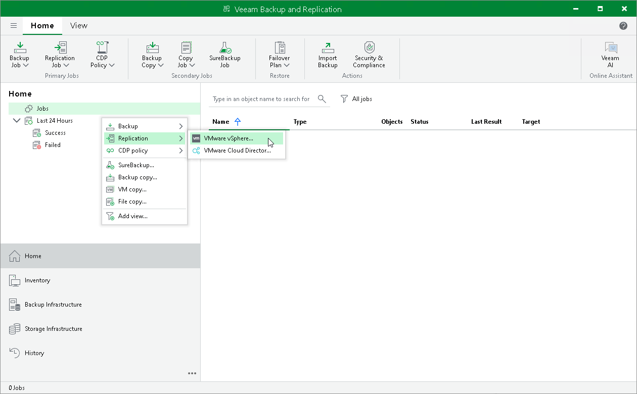

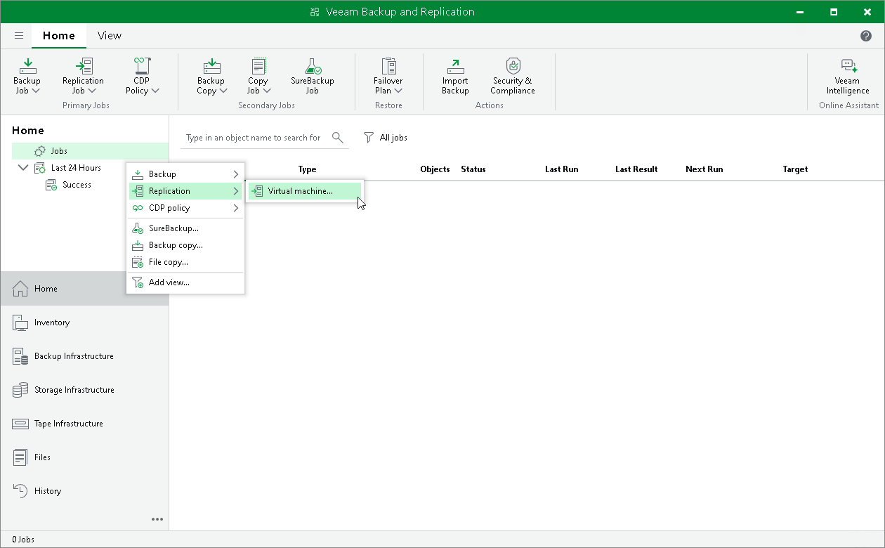

Step 1. Launch New Replication Job Wizard
To launch the replication wizard, do one of the following:
  • On the Home view. On the ribbon, click Replication Job > Virtual machine > <Platform>.
  • Open the Home view. In the inventory pane right-click the Jobs node and select Replication > Virtual machine > <Platform>.
  • Open the Inventory view. In the working area, select VMs that you want to replicate and right-click one of them. Select Add to replication job > New job if you want to create a new replication job, or Add to replication job > <Job Name> if you want to add VMs to an existing replication job.
