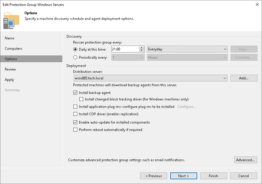

  1. Check that automatic Veeam Agent deployment options are enabled in the protection group settings:
  1. Open the Inventory view.
  2. In the inventory pane, expand the Physical and Cloud Infrastructure node.
  3. In the inventory pane, select the protection group that contains computers with an outdated Veeam Agent installed and click Edit Group on the ribbon or right-click the protection group that you want to edit and select Properties.
Deploy Hotfix on Protected Computers
  1. At the Options step of the wizard, in the Deployment section, make sure that the Install backup agent automatically and Auto-update backup agent check boxes are selected.
