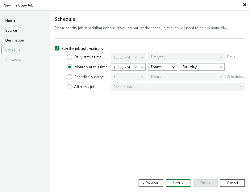

Step 5. Define Job Schedule
At the Schedule step of the wizard, you can choose to run the file copy job manually or schedule it to run regularly.
To specify the job schedule:
  1. Select the Run the job automatically check box. If you do not select this check box, you will have to start the job manually to copy files or folders.
  2. Define the scheduling settings for the job:
    • To run the job at a specific time daily, on selected weekdays, or with specific periodicity, select the Daily at this time option. Use the fields on the right to configure the schedule.
    • To run the job once a month on specific days, select the Monthly at this time option. Use the fields on the right to configure the schedule.
When you configure the job schedule, consider possible changes in date and time, such as those related to daylight saving time transition.
  • To run the job repeatedly throughout the day with a set time interval, select the Periodically every option. In the field on the right, select the time unit: Hours or Minutes. Click Schedule and use the timetable to define the permitted time window for the job. In the Start time within an hour field, specify the exact time when the job must start.
