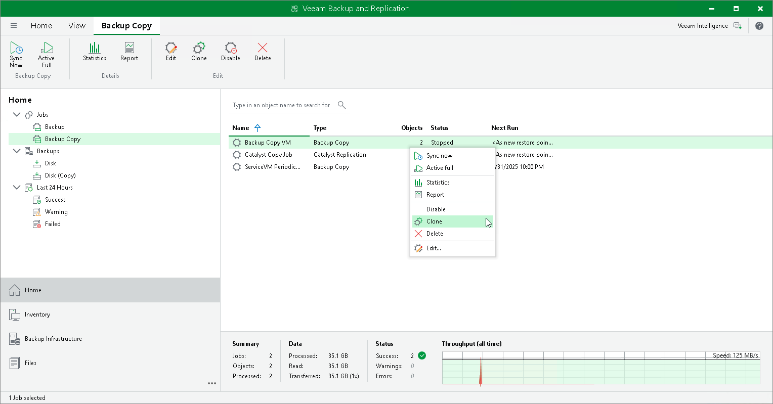

To clone a job:
  1. Open the Home view.
  3. In the working area, select the backup copy job and click Clone on the ribbon or right-click the job and select Clone.
  4. After a job is cloned, you can edit all its settings, including the job name.
