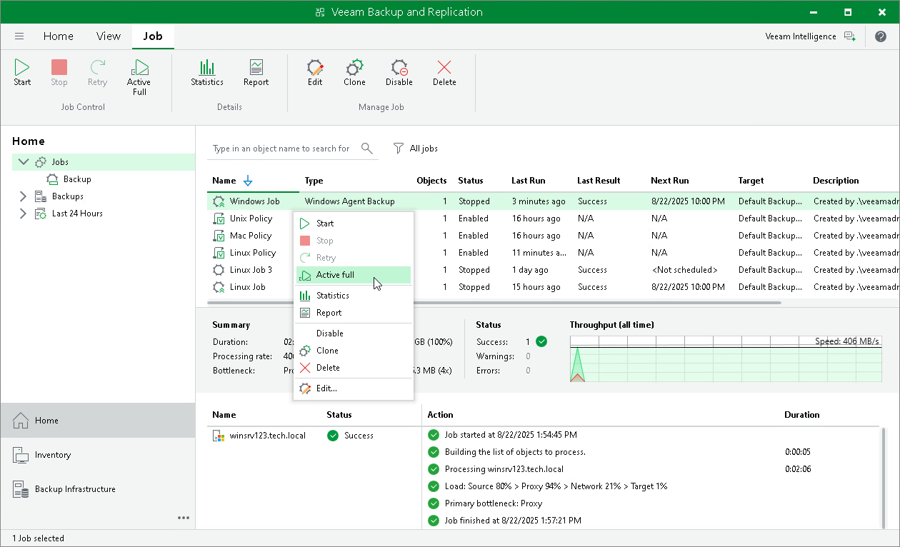

  1. Open the Home view.
  3. In the working area, select the Veeam Agent backup job and click Active Full on the ribbon or right-click the job and select Active Full.

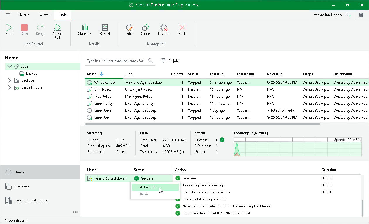

  3. In the working area, select the Veeam Agent backup job.
  4. In the bottom part of Veeam Backup & Replication, find the list of computers that are processed by the selected backup job. In the list, right-click the computer and click Active full.
Keep in mind the following:
  • You will be able to create an active full backup for another computer in the same job only after active full backup is created for the selected computer.
  • You cannot create an active full backup of a failover cluster node.
Perform Full Backup for Individual Computer

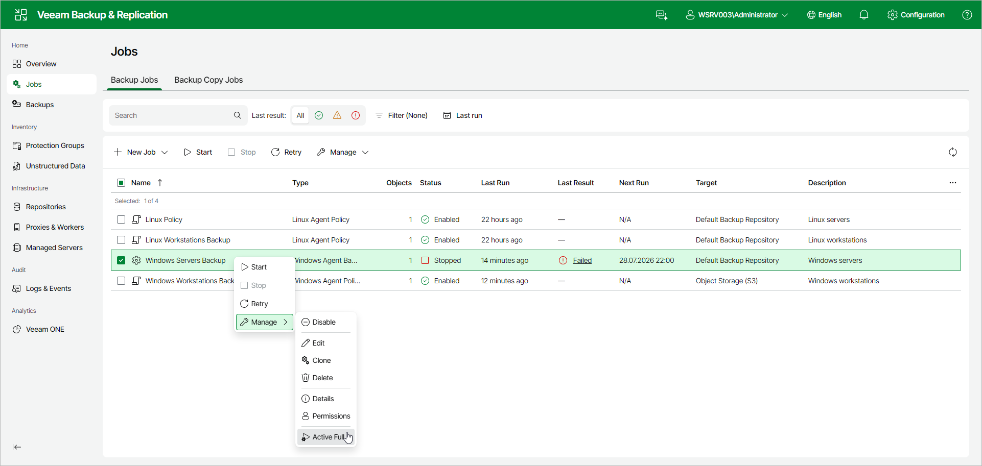

Performing Active Full Backup Using Veeam Backup & Replication Web UI
NOTE
In the Veeam Backup & Replication web UI, you can create an active full backup only for all computers in a backup job. To create an active full backup for an individual computer, use the Veeam Backup & Replication console.
To create an active full backup:
  1. In the management pane, click Jobs.
  2. Select the check box next to the necessary backup job, and from the Manage drop-down list, select Active Full. Alternatively, right-click the job and click Manage > Active Full.
