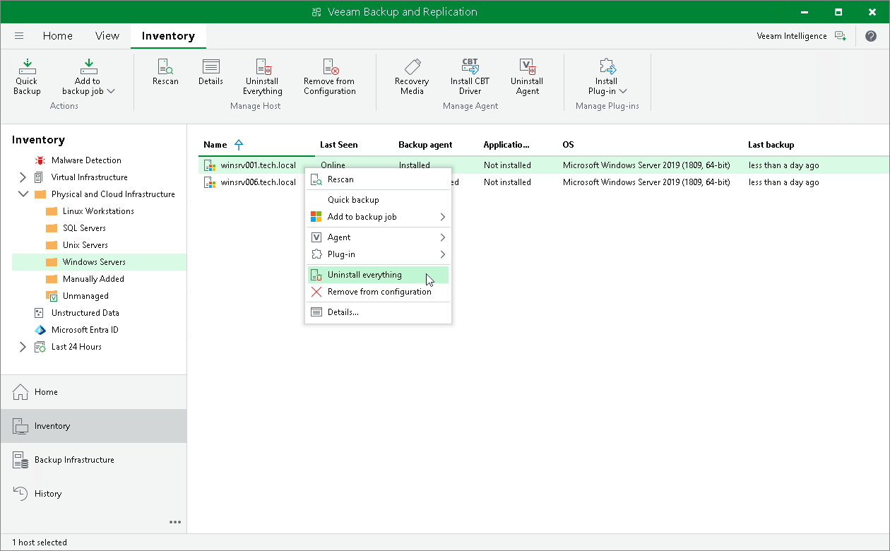

Uninstalling Veeam Agent and Other Veeam Components Using Veeam Backup & Replication Console
To uninstall Veeam Agent, Veeam Plug-Ins and Veeam components in the Veeam Backup & Replication console:
  1. Open the Inventory view.
  2. In the inventory pane, expand the Physical and Cloud Infrastructure node and select the necessary protection group.
  3. In the working area, select the necessary computer and click Uninstall Everything on the ribbon or right-click the computer and select Uninstall everything.
  4. In the confirmation window, click Yes.
Uninstall all components

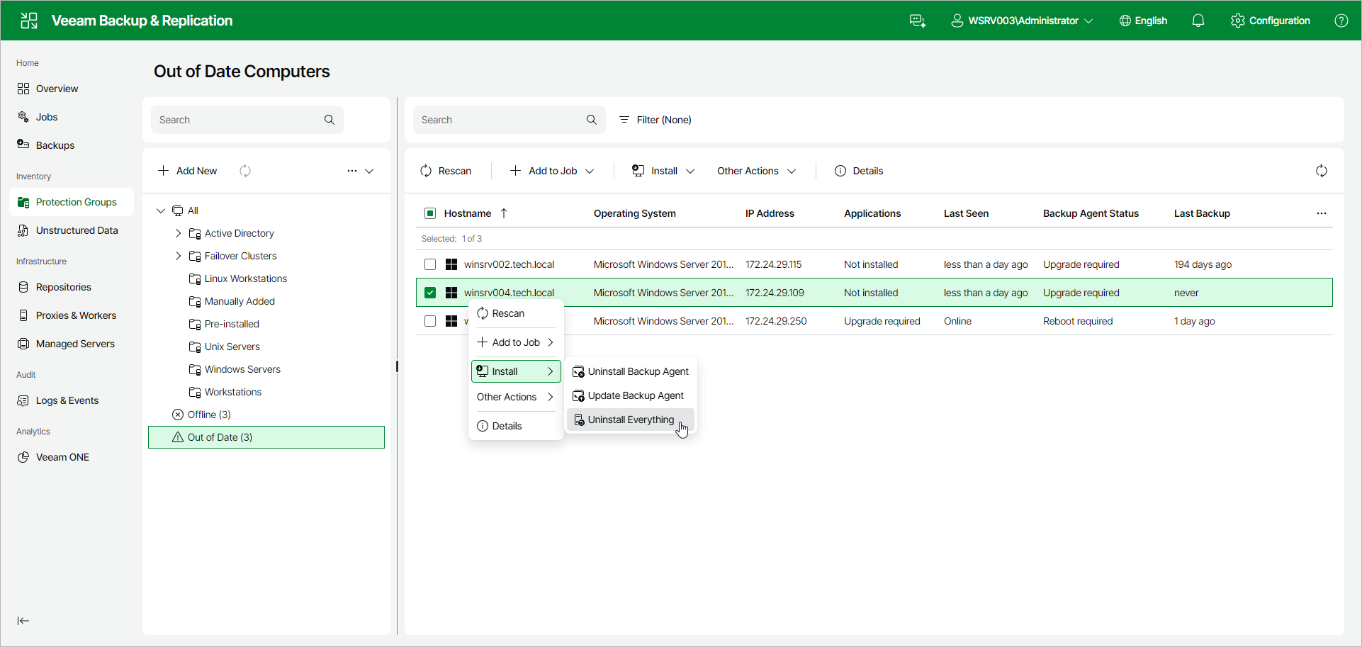

Uninstalling Veeam Agent and Other Veeam Components Using Veeam Backup & Replication Web UI
To uninstall Veeam Agent, Veeam Plug-Ins and Veeam components in the Veeam Backup & Replication web UI:
  1. In the management pane, click Protection Groups.
  2. Select the protection group that contains the necessary computer.
  3. In the working area, select the check box next to the computers and click Install > Uninstall Everything on the toolbar. Alternatively, right-click the computer and select Install > Uninstall Everything.
