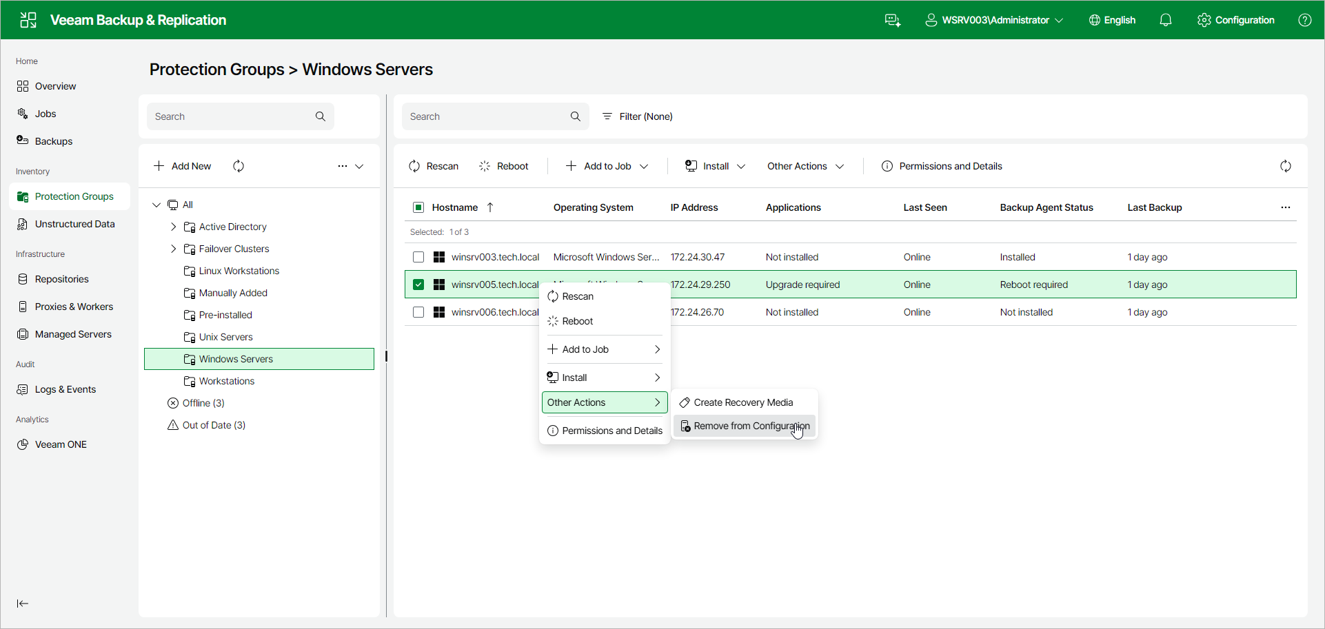

Removing Computer from Protection Group Using Veeam Backup & Replication Web UI
To remove a computer from a protection group in the Veeam Backup & Replication web UI:
- In the management pane, click Protection Groups.
- Select the protection group that contains the necessary computer.
- In the working area, select the check box next to the computers and click Other Actions > Remove from Configuration on the toolbar. Alternatively, right-click the computer and select Other Actions > Remove from Configuration.
