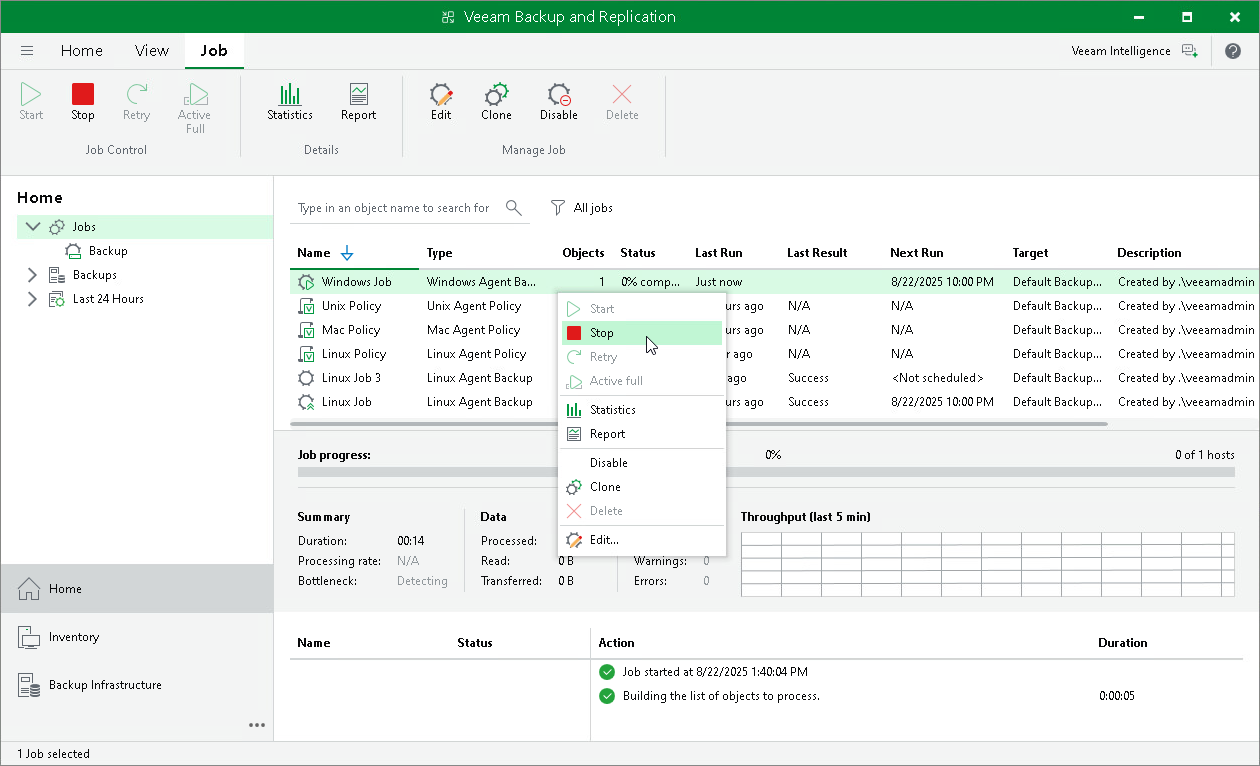

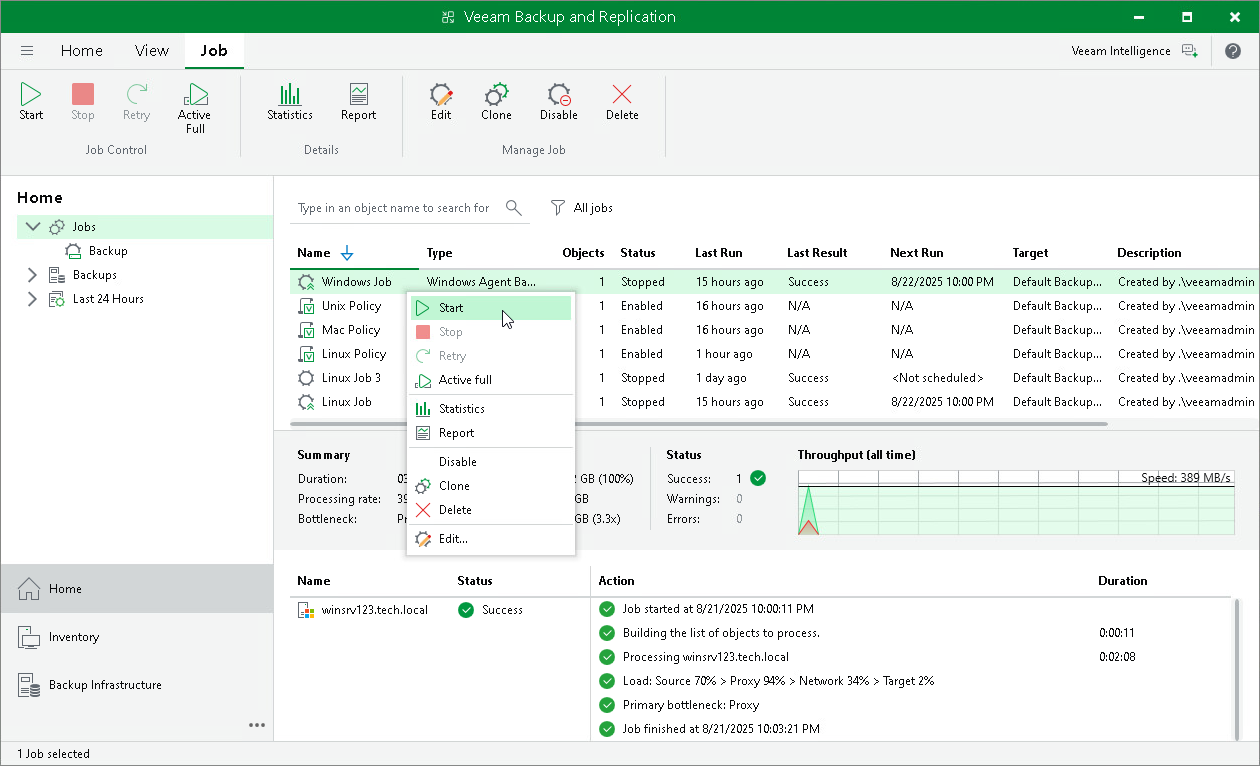

  3. In the working area, select the Veeam Agent backup job and do one of the following:
  • To start the job, click Start on the ribbon or right-click the job and select Start.
  • To stop the job immediately, click Stop on the ribbon or right-click the job and select Stop. In the displayed window, click Immediately.
  • To stop the job gracefully, right-click the job and select Stop. In the displayed window, click Gracefully.

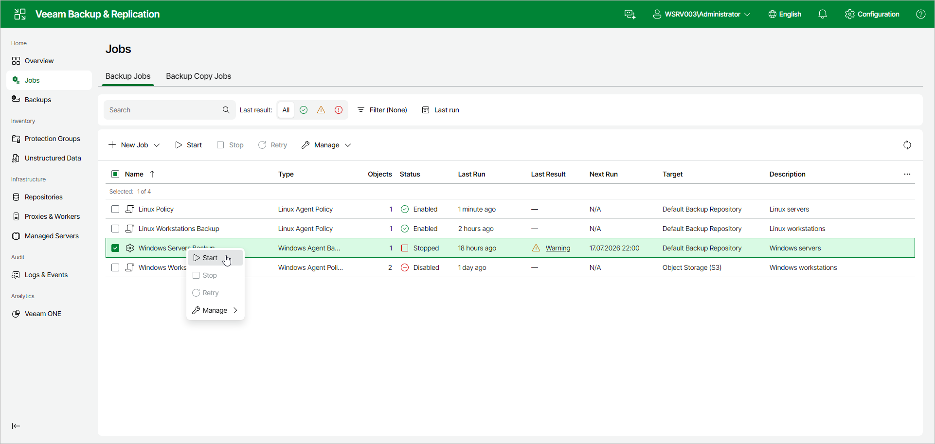

To start or stop a Veeam Agent backup job:
  1. In the management pane, click Jobs.
  2. Select the check box next to the necessary backup job and do one of the following:
  • To start the job, click Start on the toolbar or right-click the job and select Start.
  • To stop the job, click Stop on the toolbar or right-click the job and select Stop. In the Stop Job window, click Yes.
