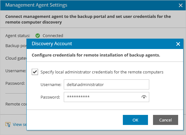

- In the master agent settings, specify credentials of an account that will be used to upload the setup file to client computers.
- Log on to a computer that hosts the master agent.
- In the icon tray, right-click the master agent icon and choose Agent Settings.
- In the Veeam Master Agent Settings window, click the Remote computer discovery user account link.
- In the Discovery Account window, select the Specify local administrator credentials for remote installation of backup agents check box.
- In the Username and Password fields, specify credentials of an account that will be used to upload the Veeam backup agent setup file to client computers.
- Click OK.
- In the Veeam Master Agent Settings window, click Close.
