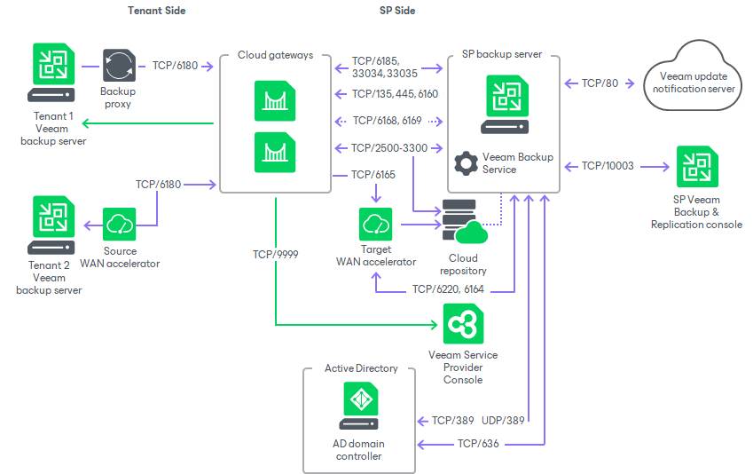

Ports in Backup Scenarios
The following diagram illustrates the interaction between Veeam Cloud Connect components and used ports in backup scenarios.

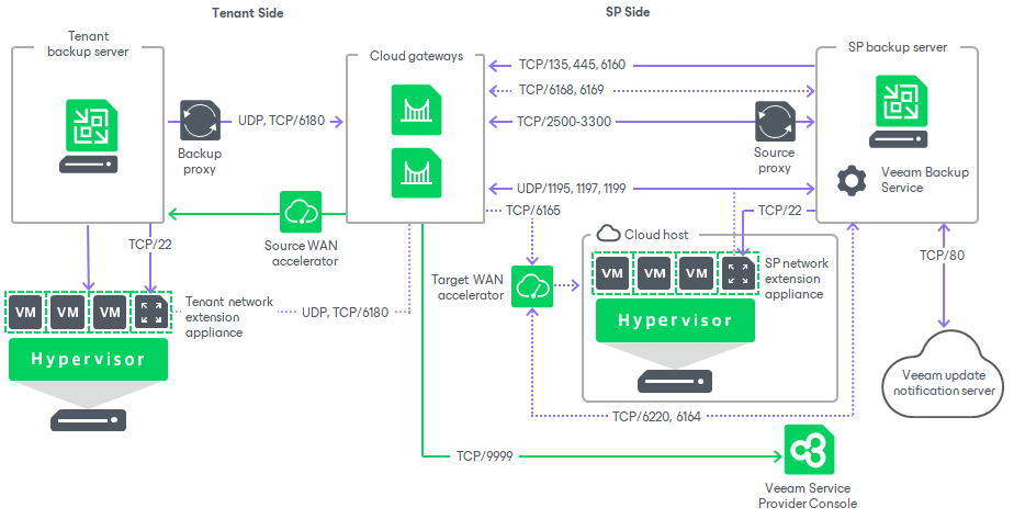

Ports in Snapshot-Based Replication Scenarios
The following diagram illustrates the interaction between Veeam Cloud Connect components and used ports in snapshot-based replication scenarios.

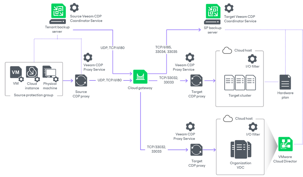

Ports in CDP Scenarios
The following diagram illustrates the interaction between Veeam Cloud Connect components and used ports in CDP replication scenarios.

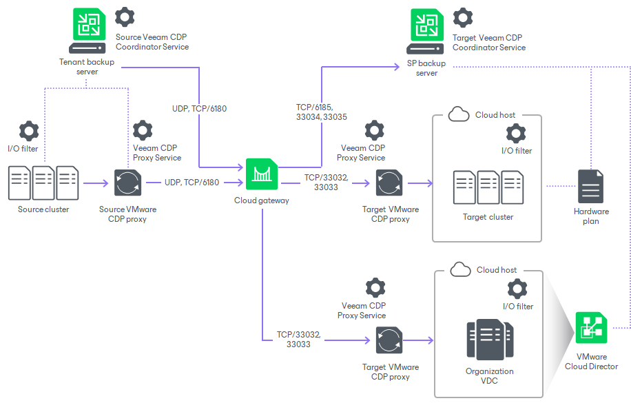

Ports in Universal CDP Scenarios
The following diagram illustrates the interaction between Veeam Cloud Connect components and used ports in Universal CDP replication scenarios.

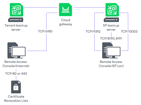

Ports in Remote Access Console Scenarios
The following diagram illustrates the interaction between Veeam Cloud Connect components and used ports in the Remote Access Console scenarios.
