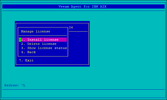

    Installing License
    1. In the Manage license menu, select Install license.
    Installing License
    1. In the Install license form, type a path to the license key and select OK.
    Installing License
    1. Veeam Agent for IBM AIX will install the license and display a notification informing that the license is successfully installed. Press any key to finish the license installation process.
