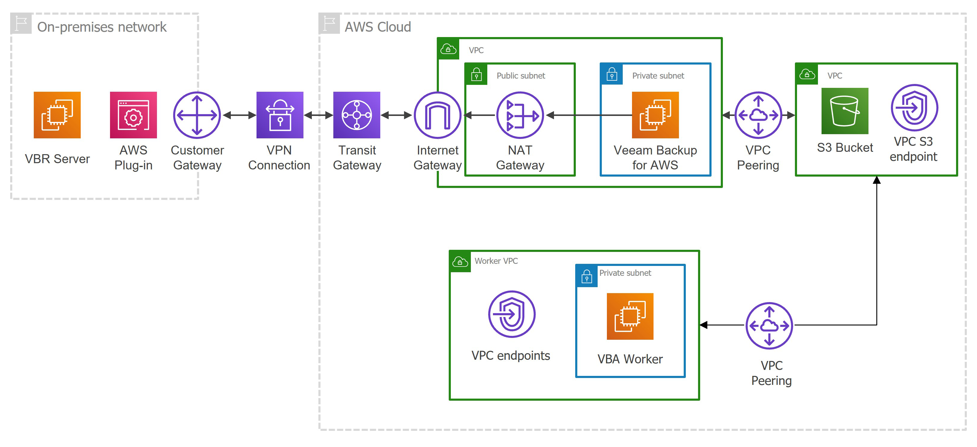

Starting from Veeam Backup for AWS version 7.0, you can deploy backup appliances in private networks to increase the security of your environment. When a backup appliance is deployed in a private environment, it is not assigned any public IPv4 address, and you will have to perform a number of additional configuration actions to allow private network access.
When deploying a backup appliance from the Veeam Backup & Replication console, the only option is to connect it to an existing VPC. In this case, you must allow communication between the Veeam Backup & Replication server and the backup appliance. One possible solution is to establish an AWS Site-to-Site VPN connection between the VPC of the appliance and your on-premises network, as described in Configuring Access to Backup Appliances in AWS.
Even though private deployment of Veeam Backup for AWS ensures private communication between Veeam Backup & Replication servers and backup appliances, the product still uses some public endpoints to interact with AWS services and requires outbound internet access to a number of online repositories.
