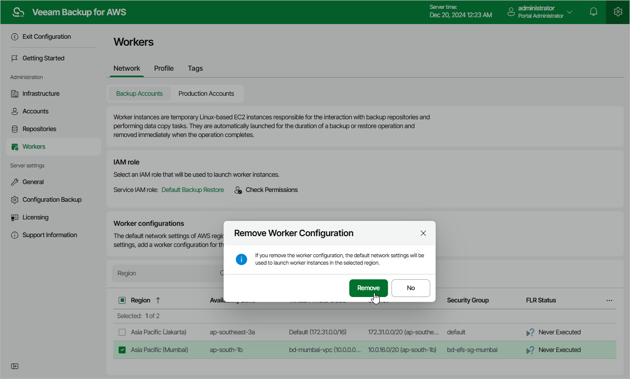

To remove a worker configuration from Veeam Backup for AWS, do the following:
  2. Navigate to Workers > Network.
  3. Switch to the necessary tab.
  4. Select the worker configuration and click Remove.
If there are any worker instances created based on the selected configuration that are currently involved in a backup or restore process, these instances will be removed only when the process completes.
