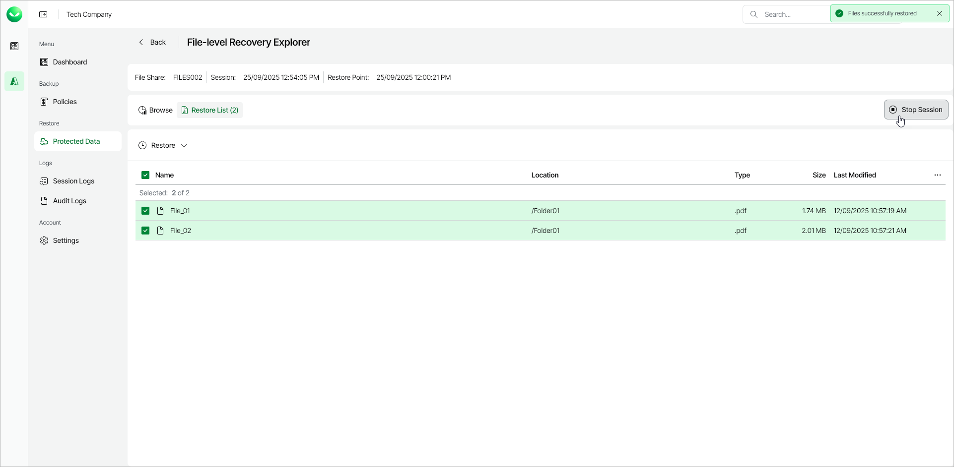

To stop the restore session, do one of the following:
- On the File-level Recovery Explorer page, click Stop Session. Veeam Data Cloud will stop the mount session and return to the page with the list of protected file shares.

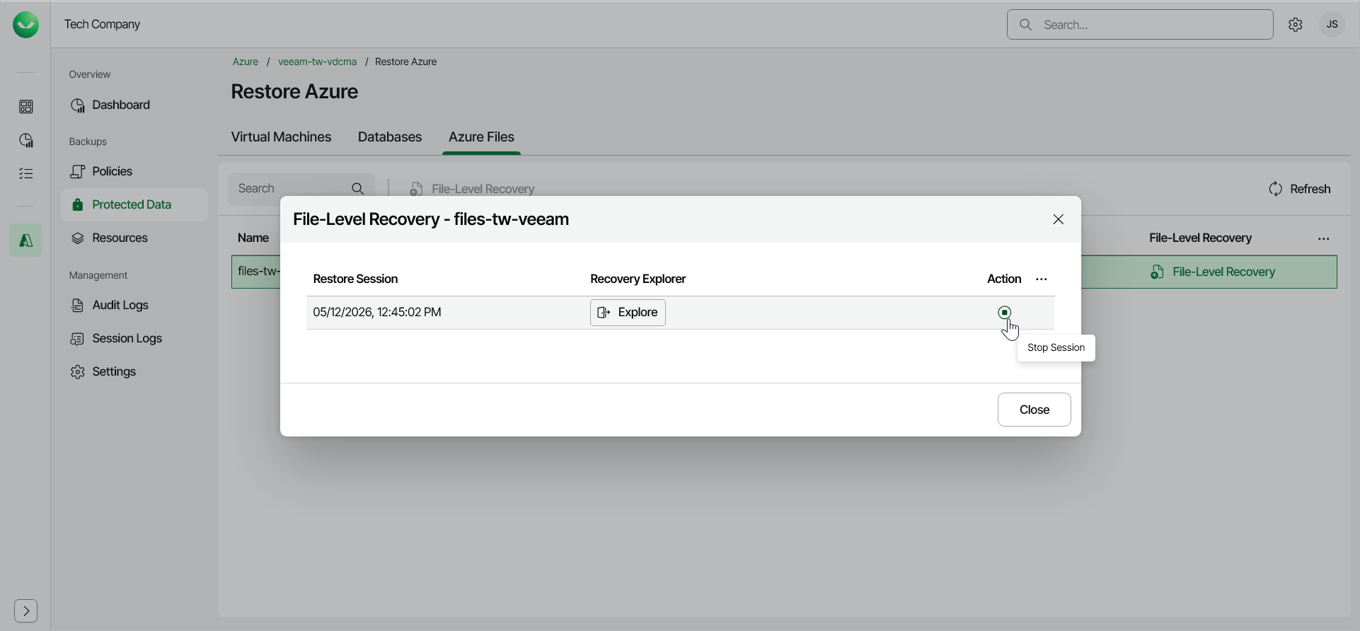

- In the Restore section of the main menu, navigate to Restore Azure > Azure Files and do the following:
- Locate the Azure file share whose files you are restoring and, in the File-level Recovery column, click the File-level Recovery link.
- In the File-level Recovery window, click Stop Session.
