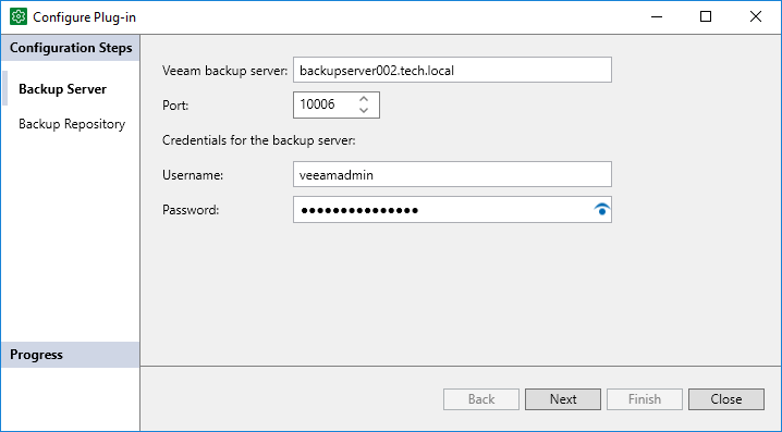

  1. On the Veeam Plug-In server, launch the Configure Plug-In wizard and set the scale-out repository as the target for backups:
Veeam Backup Repositories
Alternatively, you can use the following command in the command line interface:
MSSQLConfigTool --set-repository

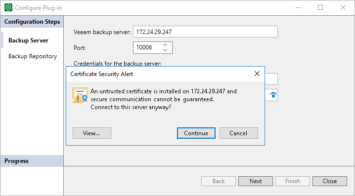

  1. If you connect to the specified Veeam Backup & Replication server for the first time, Veeam Plug-In displays the Certificate Security Alert window. After you review the certificate, click Continue to confirm the connection.

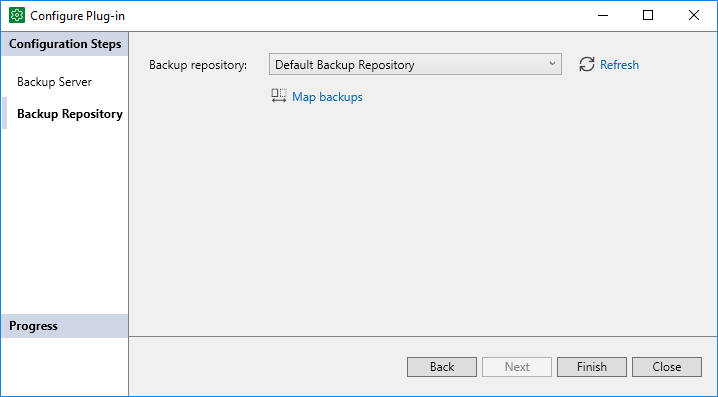

  1. At the Backup Repository step of the wizard:
  1. From the Backup repository drop-down list, select the scale-out repository.
  2. Click Map backups to map the imported backups stored in the backup repository.
You can map backups only in the graphic user interface.

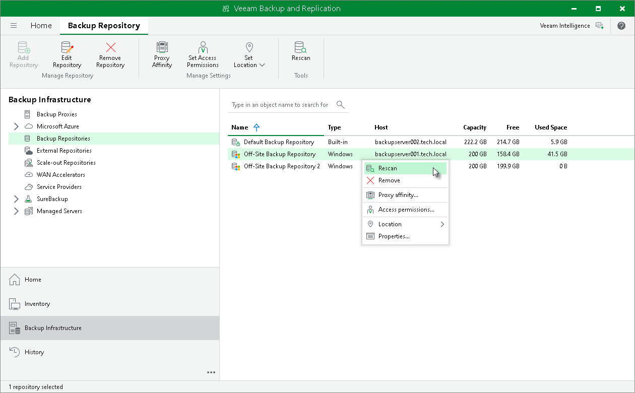

As a result of malware activity or unplanned actions, backup job metadata files (.VACM) may become unavailable in the hardened repository. In such cases, to restore data from the hardened repository, Veeam Backup & Replication can regenerate the .VACM file based on information from the backup job storage metadata file (.VASM).
To restore backup availability in the Veeam Backup & Replication console, do the following:
  2. In the inventory pane of the Backup Infrastructure view, select the Backup Repositories node.
  3. In the working area, select the backup repository containing the required backup and click Rescan on the ribbon. Alternatively, you can right-click the backup repository and select Rescan.
As a result, the backup will appear in the Veeam Backup & Replication console as an imported backup. You can perform all available restore operations for imported backups with the newly imported backup.
