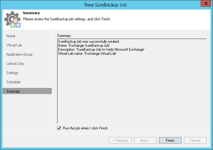

Step 9. Review Job Summary and Finish Working with Wizard
At the Summary step of the wizard, complete the procedure of SureBackup job configuration.
- Review details of the SureBackup job.
- If you want to start the job right after you finish working with the wizard, select the Run the job when I click Finish check box.
- Click Finish to save the job settings and close the wizard.
