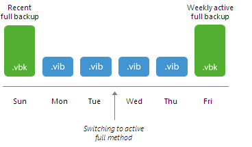

    Switching from Synthetic to Active Full Method
    After you switch from the synthetic to the active method of archive backup creation, Veeam Backup & Replication does not perform synthetic transform operations for some time. Veeam Backup & Replication works in the following way:
    1. Veeam Backup & Replication will add new incremental restore points to the backup chain and keeps existing restore points until a new active full backup is created.

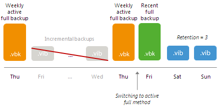

    1. Veeam Backup & Replication will add a new active full backup to the backup chain.

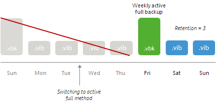

    1. Veeam Backup & Replication will keep adding new incremental restore points to the backup chain. When the number of restore points in the new backup chain is equal to the number allowed by retention, Veeam Backup & Replication will remove incremental restore points that precede the new active full backup.

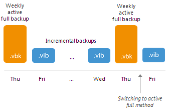

    After this, Veeam Backup & Replication will use the new method to create the backup chain in a regular manner.
