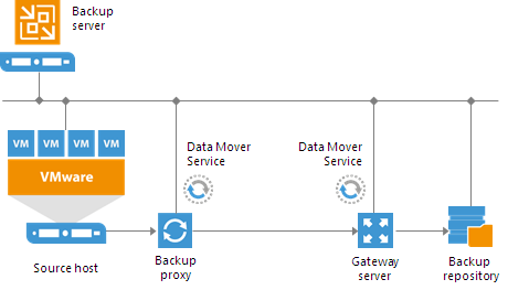

Gateway Server
A gateway server is an auxiliary backup infrastructure component that “bridges” the backup server and backup repository. The gateway server is required if you deploy the following types of backup repositories in the backup infrastructure:
  • Shared folder backup repositories
  • EMC DataDomain and HPE StoreOnce deduplicating storage appliances
Shared folder repositories, EMC DataDomain and HPE StoreOnce cannot host Data Mover Services — Veeam components that establish a connection between a backup proxy and backup repository (in case of backup jobs) or between backup repositories (in case of backup copy jobs). To overcome this limitation, Veeam Backup & Replication uses gateway servers.
In the backup infrastructure, a gateway server hosts the target Veeam Data Mover. Veeam Backup & Replication establishes a connection between the source Veeam Data Mover and target Veeam Data Mover, and transports data from/to backup repositories via gateway servers.
Gateway Server
Gateway Servers Deployment
