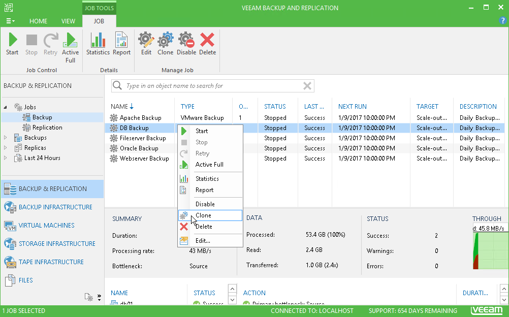

    To clone a job:
    1. Open the Backup & Replication view.
    3. In the working area, select the job and click Clone on the ribbon or right-click the job and select Clone.
    4. After a job is cloned, you can edit all its settings, including the job name.
