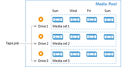

Parallel Processing with Do not Create, Always Continue Using Current Media Set Option
When the media pool is set to the Do not create, always continue using current media set option, a media set is opened per each drive during the first tape session. The next time a tape job starts, it chooses a tape that has most free space, and appends data to it.
For example, you set the maximum number of drives to 3. The tape jobs that are first to run start 3 media sets. The following tape sessions continue these 3 media sets appending data to them.

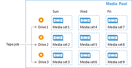

Parallel Processing with Create New Media Set for Every Backup Session Option
When the media pool is set to the Create new media set for every backup session option, a media set is opened per each drive for every writing session. When the jobs run the next time, they open a number of media sets anew.
Each media set uses a free tape. Note that this configuration is the most tape-consumptive.

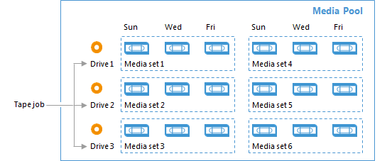

Parallel Processing with Daily at Option
When the media pool is set to Daily at option, a number of media sets (per each drive) is opened on the scheduled day. If tape jobs run twice or more before the scheduled day, they continue these media sets — in this case, the jobs use tapes that have most free space first.
