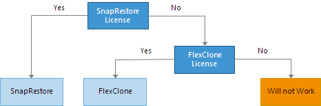

    7-mode
    If the NetApp storage system operates in the 7-mode, you must have a FlexClone or SnapRestore license installed, or the NDMP protocol enabled.
    Veeam Backup & Replication uses the following technologies for LUN clone creation:
    • If you have a FlexClone license installed, Veeam Backup & Replication uses the FlexClone technology.
    • If you have a SnapRestore license installed, Veeam Backup & Replication uses the SnapRestore technology.
    If neither FlexClone nor SnapRestore license is installed, Veeam Backup & Replication uses the NDMP protocol. If the NDMP protocol is not enabled, VM data restore will fail.

    C-mode
    If the NetApp storage system operates in the C-mode, you must have a FlexClone or SnapRestore license installed.
    If neither FlexClone nor SnapRestore license is installed, VM data restore will fail.
