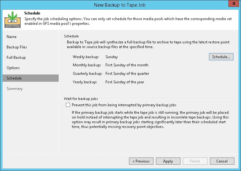

Schedule for GFS Job
This step of the wizard is available if you selected a GFS media pool at the Full Backup step of the wizard.
Click Schedule to select days for each media set. The GFS job starts at 00:00 on the selected day.
| After you specify necessary schedule settings, you can save them as default. To do this, click Save as Default at the bottom left corner of the Archival Schedule window. When you create a new GFS job, Veeam Backup & Replication will automatically apply default settings to the new job schedule. |
Sometimes, the primary job may start when the tape job is still running. By default, the primary job has priority. In this case, the tape job terminates with error and no data is written to tape. Select the Prevent this job from being interrupted by primary backup jobs option if you want to give the tape job a higher priority. If this option is selected, the primary job will wait until the tape job finishes. Note that the primary job may start with a significant delay.
