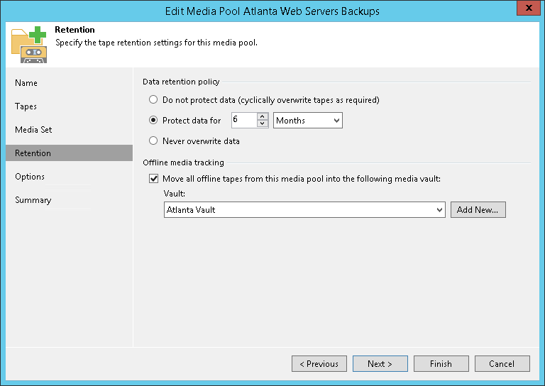

Automatic Vaulting for Simple Media Pools
To set the automatic placing of tapes to a vault, you need to configure the media pool where the target tapes are recorded. To configure a simple media pool:
- Open the Tape Infrastructure view and select the Media Pools node.
- Select the media pool you want to customize.
- Click Edit Media Pool on the ribbon. Alternatively, you can right-click the media pool and select Properties.
- Go to the Retention step of the Edit Media Pool wizard: in the Offline media tracking field, select Move all offline tapes from this media pool into the following media vault. Select the needed vault from the drop-down list.
Note that moving tapes to a vault automatically will not be available if you select Do not protect data (cyclically overwrite tapes as required) option as a data retention policy.
If you have not previously created a media vault, you can click the Add New button and create a new media vault without closing the job wizard. For more details, see Creating Media Vaults. |

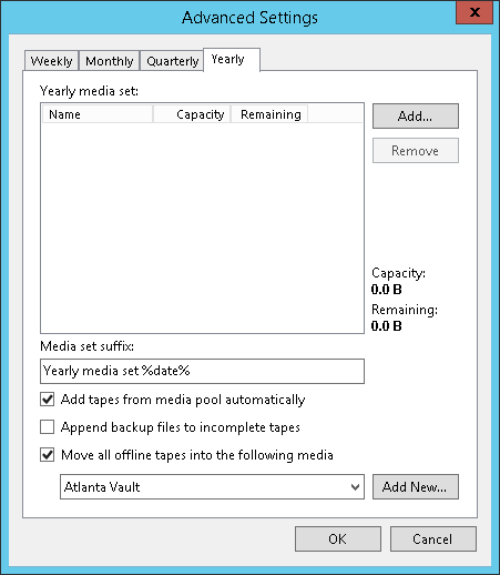

Automatic Vaulting for GFS Media Pools
Vaulting of GFS tapes is set for media sets individually. To change a media set configuration:
- Select the GFS media pool you want to customize.
- Go to the GFS Media Set step of the Edit Media Pool wizard and click Advanced. Select a tab with the needed media set and select Move all offline tapes into the following media vault. Select the needed vault from the drop-down list.
