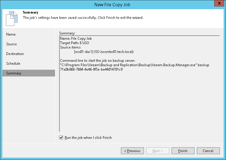

Step 6. Finish Working with the Wizard
                                At the Summary step of the wizard, complete the procedure of file copy job configuration.
- Review details for the created file copy job.
- Select the Run the job when I click Finish check box if you want to start the job right after you finish working with the wizard.
- Click Finish to close the wizard.
