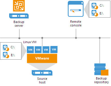

When you restore files from backups that reside on the backup repository, Veeam Backup & Replication uses the following mount points:
- Veeam Backup & Replication mounts disks of the VM from the backup file to the machine where the restore process is launched. This can be the backup server or machine on which the Veeam Backup & Replication console is installed. This mount point allows you to browse the VM file system.
- If you restore files to the original location, Veeam Backup & Replication creates an additional mount point on the mount server associated with the backup repository on which the backup file resides. The second mount lets you keep the VM traffic in one site and reduce load on the network.
If you restore files to a new location (perform the Copy to operation), Veeam Backup & Replication does not create the second mount point. It simply copies files to the destination from the backup server or Veeam Backup & Replication console machine.
Backup files on HPE StoreOnce are locked exclusively by a restore task. For this reason, Veeam Backup & Replication uses only one mount point on the backup server or Veeam Backup & Replication console machine for backups on HPE StoreOnce. |

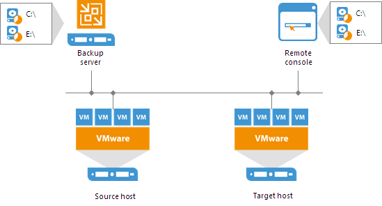

When you restore files from a VM replica, Veeam Backup & Replication uses the following mount points:
- Veeam Backup & Replication mounts disks of the VM replica to the machine where the restore process is launched. This can be the backup server or machine on which the Veeam Backup & Replication console is installed. This mount point allows you to browse the VM file system.
- If you start the restore process from the Veeam Backup & Replication console and restore files to the original location, Veeam Backup & Replication creates an additional mount point on the backup server.
If you start the restore process on the backup server or restore files to a new location (perform the Copy to operation), Veeam Backup & Replication does not create the second mount point. It simply copies files to the destination from the backup server or Veeam Backup & Replication console machine.

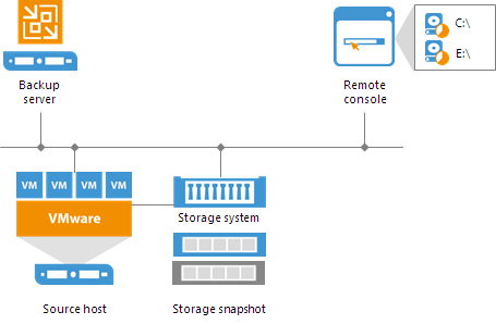

Restoring Files from Storage Snapshots
When you restore files from storage snapshots, Veeam Backup & Replication uses one mount point on the backup server or Veeam Backup & Replication console machine.

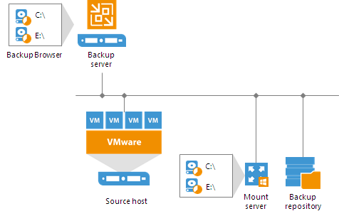

Restoring Files from Veeam Backup Enterprise Manager
When you restore files from the backup file that was created without VM guest OS file indexing, Veeam Backup & Replication uses the following mount points:
- Veeam Backup & Replication mounts disks of the VM from the backup file to the backup server.
If you select to download files, Veeam Backup & Replication does not create the second mount point. It simply copies files to the destination from the backup server.
