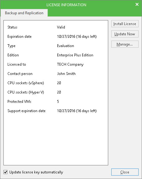

    Enabling Automatic License Update
    By default, automatic license update is disabled. To enable automatic license update:
    1. From the main menu, select License.
    2. In the License Information window, select the Update license key automatically check box.
    Updating License Automatically
    Statistics on the automatic license update process is available under the System node in the History view. You can double-click the License key auto-update job to examine session details for the scheduled or ad-hoc automatic license update.
