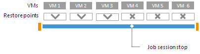

- You can stop the job immediately. In this scenario, Veeam Backup & Replication terminates the job session and does not create a new restore point for VMs that are currently processed.

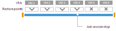

- You can stop the job gracefully. In this scenario, Veeam Backup & Replication creates a restore point for the VMs that are currently processed and then terminates the job session.
- VMs that Veeam Backup & Replication has succeeded to process by the time you stop the job will have new restore points.
- VMs that Veeam Backup & Replication is currently processing and VMs that Veeam Backup & Replication has not started to process will not have new restore points.
- If a snapshot for a VM has already been created, Veeam Backup & Replication instructs VMware vSphere to remove the snapshot.
- Veeam Backup & Replication terminates all job processes and tasks. The job is finished with the Failed error.
- VMs that Veeam Backup & Replication has succeeded to process and VMs that are being processed will have new restore points.
- VMs that Veeam Backup & Replication has not started to process will not have new restore points.
