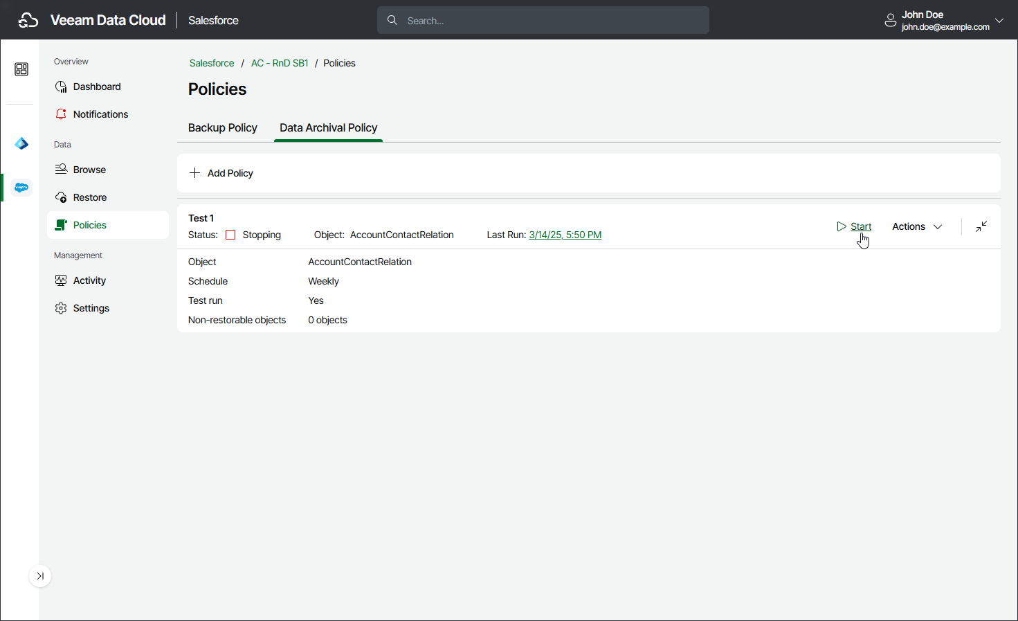

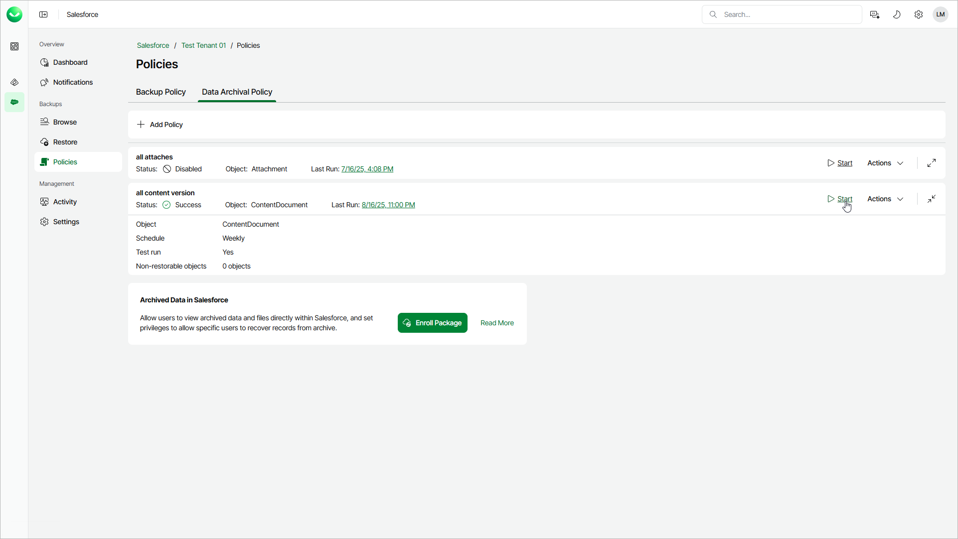

To start an archival policy:
  1. On the Salesforce page, click the name of the tenant you want to manage.
  2. To view the policies created for this tenant, select Policies on the left.
  3. On the Data Archival Policy tab, find the policy you need and click Start.
To stop an archival policy:
  3. On the Data Archival Policy tab, find the policy you need and click Stop.
  4. In the Confirm Archival Session Stop window, click Yes.
