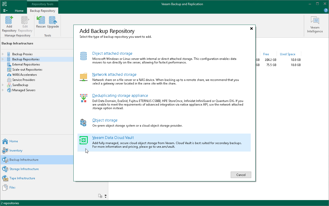

  1. In the Veeam Backup & Replication console, launch the New Object Storage Repository wizard:
  2. In the inventory pane, click the Backup Repositories node and then click Add Repository on the ribbon.
  3. In the Add Backup Repository window, select Veeam Data Cloud Vault > Veeam Data Cloud Vault.

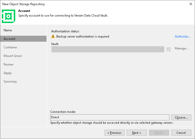

  1. At the Account step of the New Object Storage Repository wizard, click Authorize.
Connecting Veeam Data Cloud Vault with Veeam Backup & Replication Using Console
  1. In the Sign-in to Veeam Customer Portal window, enter credentials of the user account under which you access Veeam Data Cloud and click Log In.

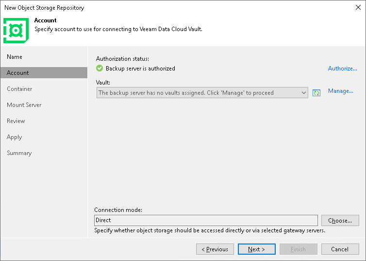

  1. If you have only one storage vault that has not been assigned to any Veeam Backup & Replication server, Veeam Data Cloud Vault will automatically assign this storage vault to your backup server. At the Account step of the New Object Storage Repository wizard, the storage vault will be automatically selected in the Vault drop-down list.
Otherwise, click Manage next to the Vault drop-down list to assign a storage vault to the backup server in Veeam Data Cloud Vault.

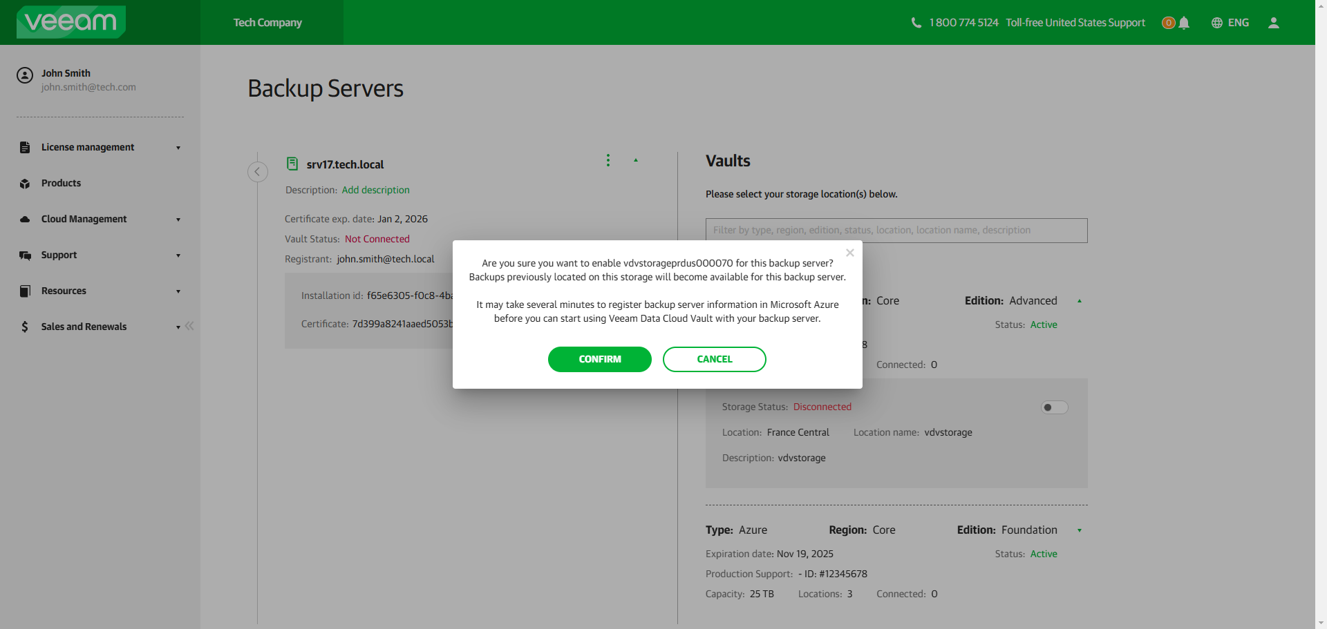

  1. In Veeam Data Cloud, on the Vault page, find the necessary tenant in the list of tenants. Click the menu icon, then click Manage.
  2. In the left menu, click Storage Vaults.
  3. On the Storage Vaults page, locate the storage vault that you want to assign to Veeam Backup & Replication and click Manage.
  4. In the Manage vault window, go to the Assignments tab and click Assign next to the necessary Veeam Backup & Replication server.
  5. In the confirmation window, click Continue.
If you have more than one storage vault configured in Veeam Data Cloud Vault, repeat this step for all storage vaults you want to become available in Veeam Backup & Replication.
For more information, see Assigning Storage Vaults to Workloads.

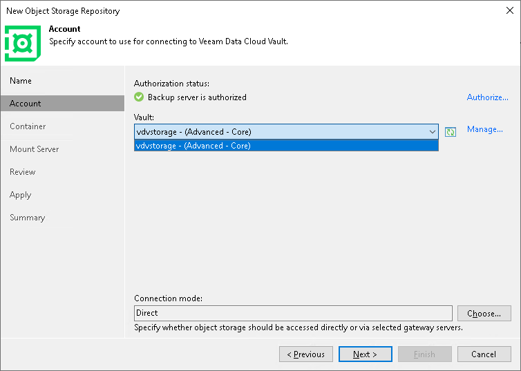

  1. In the Veeam Backup & Replication console, at the Account step of the New Object Storage Repository wizard, click the refresh icon. The storage vault will become available in Veeam Backup & Replication. Select the storage vault from the Vault drop-down list.
  1. Complete the steps of the New Object Storage Repository wizard to add the storage vault as an object storage repository in Veeam Backup & Replication.
