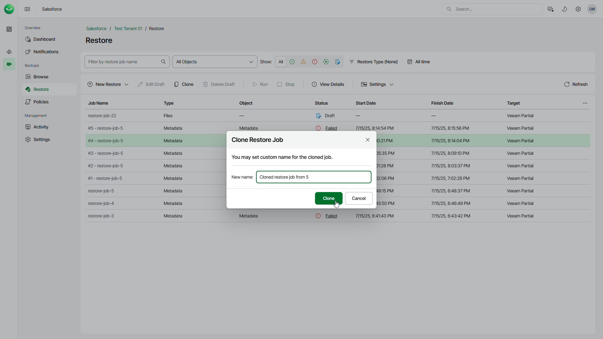

  4. Click Clone.
  5. In the Clone Restore Job window, specify a name for the new job, and click Clone.
Cloning Restore Job
