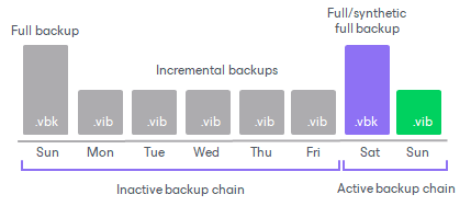

For forward incremental backup method, the active backup chain is the one that has not yet been sealed with a new full backup file.

To transform an active backup chain into inactive, a new active full (or synthetic full) backup file must be created for this chain. This can be done either manually, as described in section Performing Active Full Backup. Else, you can configure a schedule according to which new active or synthetic full backups will be created automatically, as described in sections Active Full Backup and Synthetic Full Backup.
Once a new full backup file is created and the offload session is being executed, Veeam Backup & Replication collects all the restore points (full and incremental) that were created prior to the latest active full, verifies that they belong to an inactive chain, and prepares them to be moved to capacity extents. This process is called detect. For more information, see Moving Backups to Capacity Tier.

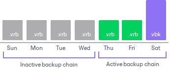

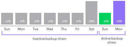

The same applies to the backup chains created with the reverse-incremental method. In this case, all the .VRB files starting from the third restore point will be considered inactive automatically. Thus, you do not need to create an active full (nor synthetic full) backup manually unless you want to offload all the restore points including the most recent .VBK file and the first two .VRB files.
Consider the following examples:
  • Four VRB files are inactive and can be offloaded:

  • Six VRB files and a VBK file belong to an inactive chain and can be offloaded:

A full backup file and the first two incremental backup files (that is, two .VRB files that immediately follow the most recent .VBK file) will not be offloaded until another full backup file is created successfully.
