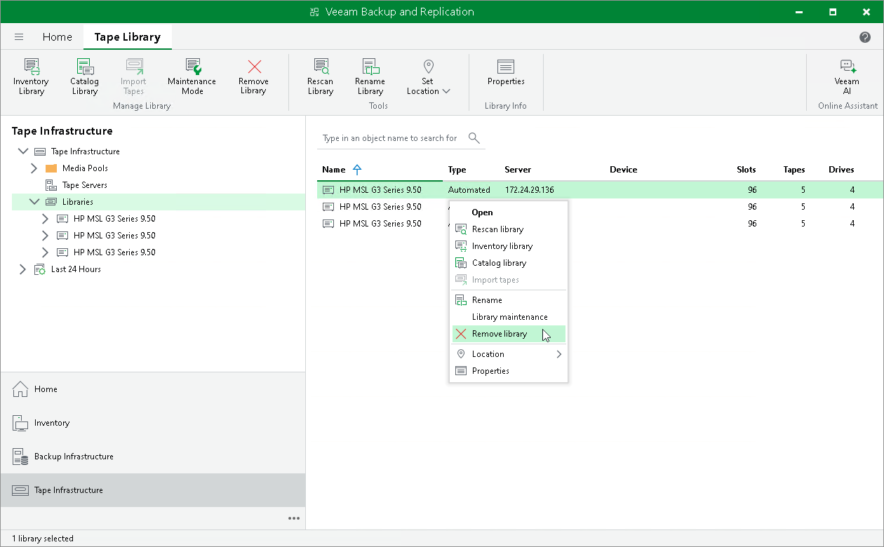

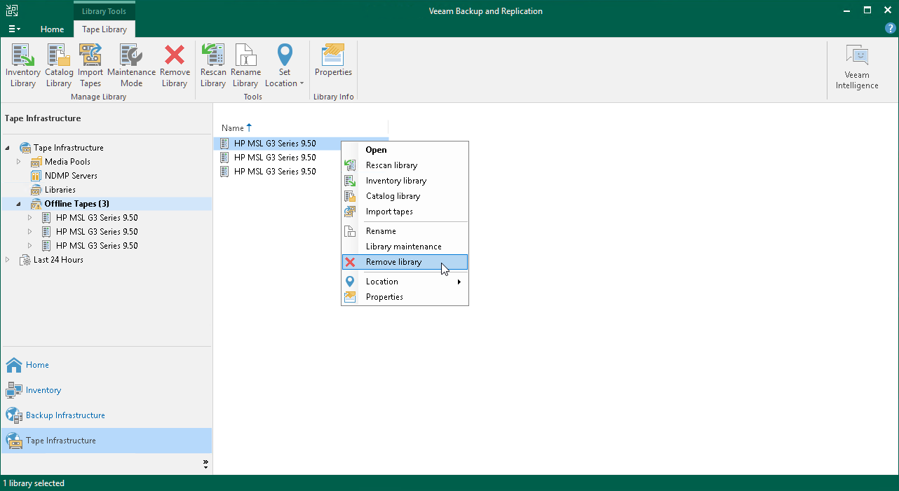

  2. Open the Tape Infrastructure view.
  3. Select the Libraries node in the inventory pane.
  4. Select a necessary item in the working area and click Remove Library on the ribbon. You can also right-click the necessary device in the working area and select Remove library.
  5. In the displayed dialog box, click OK to confirm deletion.
